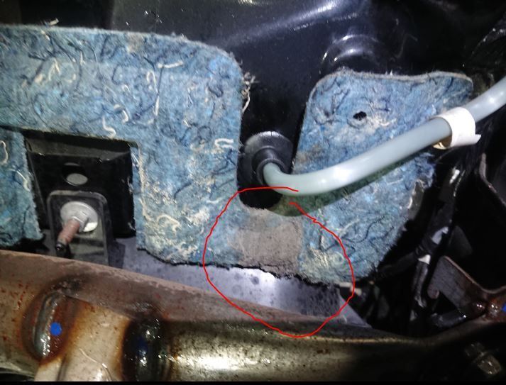

While crawling under the car I spotted cracks in the body where front passenger feet should be.
I poked it with hand and it broke loose

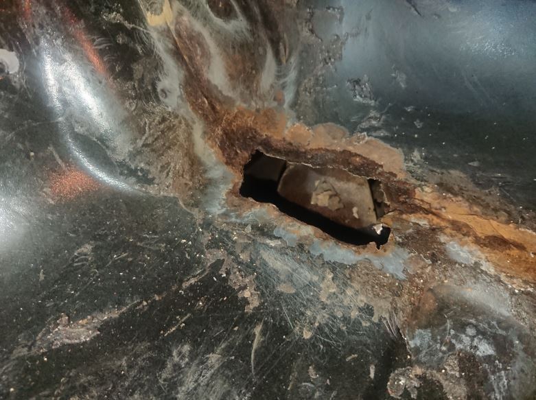

Removing carpet damage was not immediately visible:

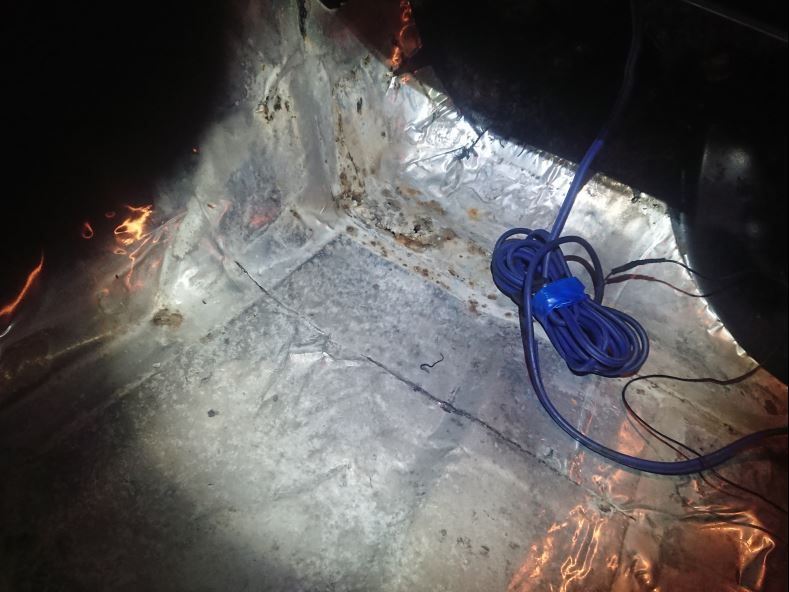

Taking off this heat/whatever isolation was pain in the ***(probably there is easy way to do it).
A nice hole, straight to the exhaust pipe to warm feet:
Possibly biggest factor was the heat insulator that trapped moisture in there and it could not evaporate + heat and micro cracks in pain = rust heaven.

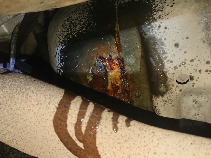

Leaky sunroof tube signs:

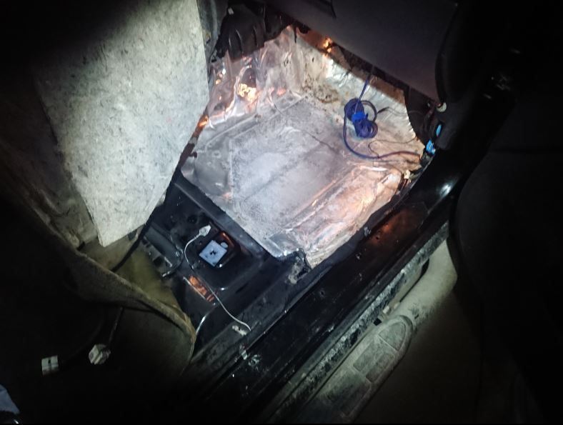

Next: grind/cut and wield it back together, paint, smear something like fluid film on it and put heat shield back again.
Without heat shielding that place gets hot.
I wonder if I can wrap heat shield(cloth) directly around exhaust.
