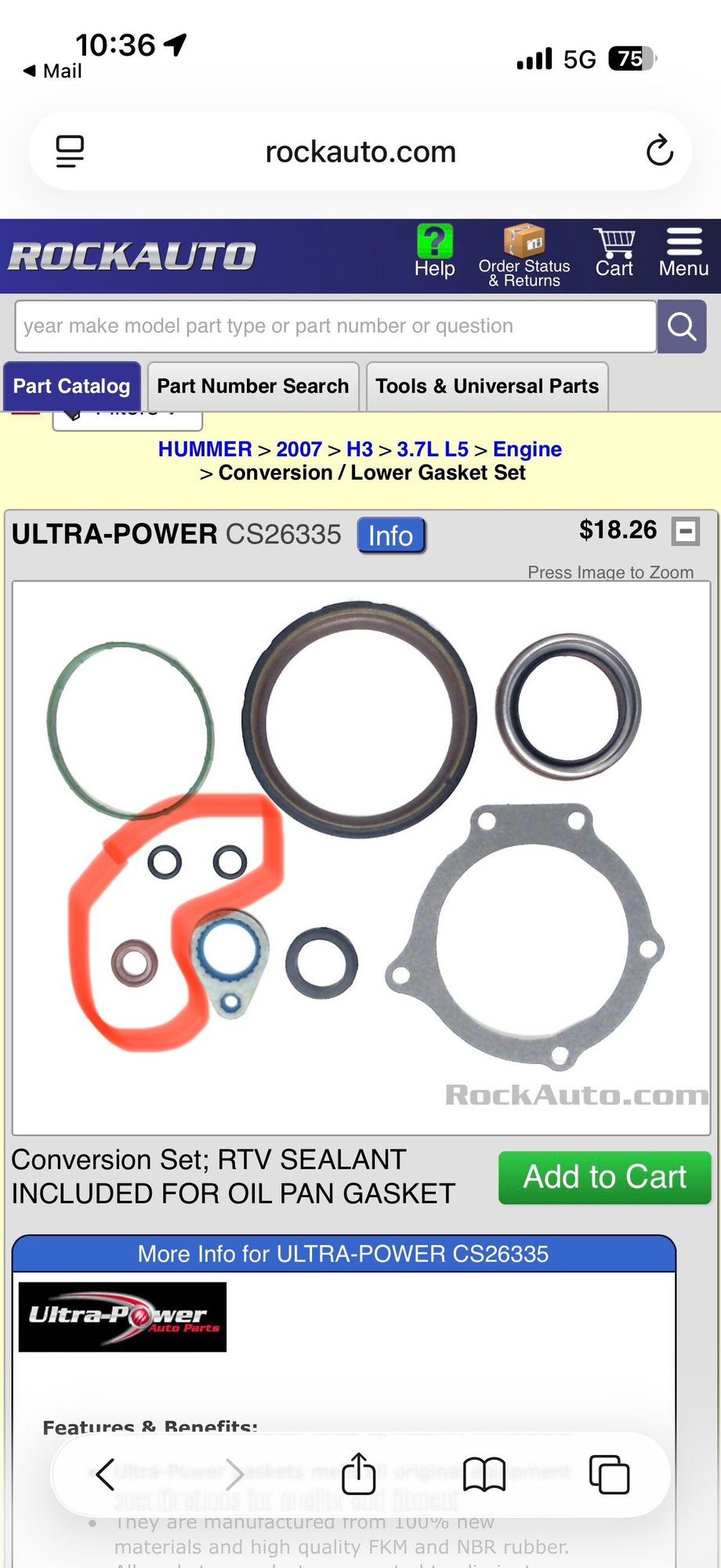

I ordered a kit
I know all the seals and where they go but those 3. What are those for ??
