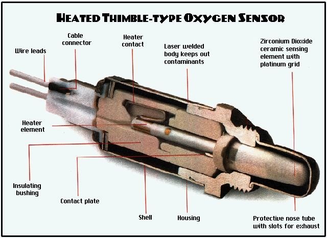

I've used Kroil many times and it always works. Spray and tap. Don't get in a hurry. Yesterday I sprayed and tapped 4 times on the drivers side forward. This morning I put the 02 socket on and out she came with very little effort . Waiting for my new 02 sensors to arrive. They will be installed with the copper anti-seize . I put the old ones in brake cleaner fluid. Tomorrow I'll finish cleaning them. Pack them away, Why? I don't know. I do dumb things to entertain my self. However some time ago I took them out of my Lexus RX 300. Cleaned them. Reinstalled and worked great.

brake cleaner can damage them. the safest way is to just burn the tips clean on the stove or with a torch. it will remove the unburnt fuel caking them/ (black soot)

Burning the tips doesn't clean the element. Best way, perform an induction clean while they are installed. Uninstalled, torch/heat up the the tips and dunk them in water, or heat up the tips and clean with crc.
