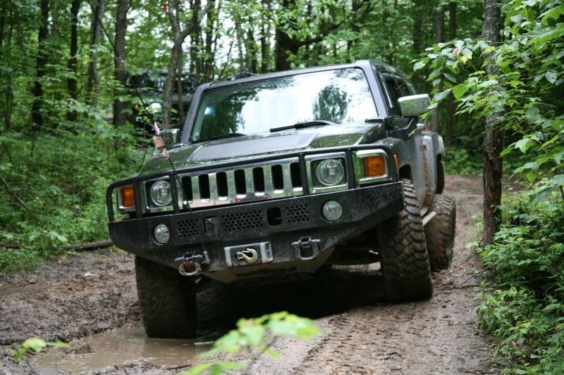

Here is my 07, the 09 has the same set up, "nose dive" only happens when you brake hard to a stop, the rest of the time the truck never has contact with the bump stops until wheeling and flexing. There is no right or wrong answer, I don't need anything other than OEM bump stops. I had to replace the fronts on the 09 as they were destroyed before I bought it, the left side was half gone. The prior owner never leveled the front, so it always sat on the stops and age/miles took their toll.
