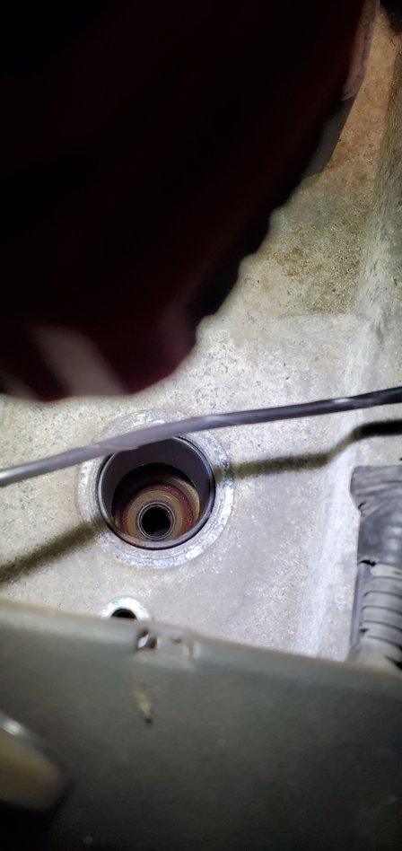

When I bought it more than year ago, 1st thing i did, its change the spark plugs, because the engine was misfiring badly. So the 1st thing i noticed when took off the coils, that the 1st cylinder was full of water. So I wondered right away it was source of that issue. Anyways, I dry it with air, change the plugs and obviously the problem vas gone.

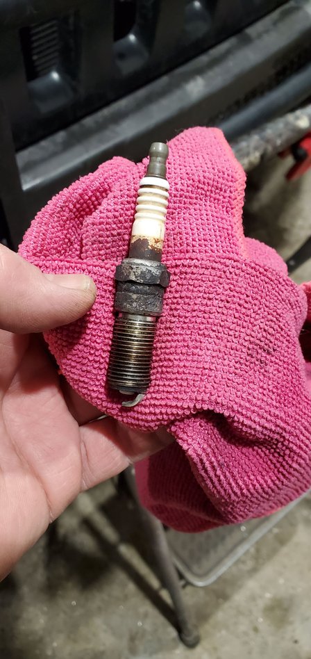

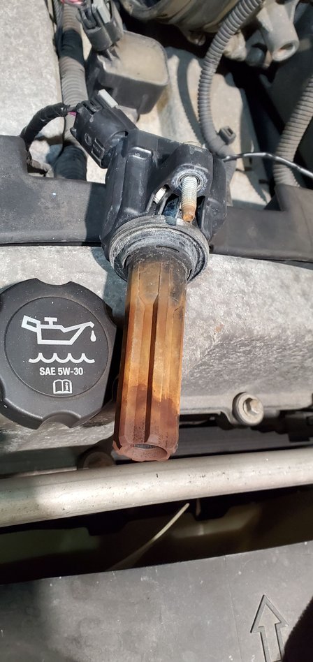

2 days ago the engine start to misfire.. worst and worst , when plug computer (see picture) right away i though about moist in 1st cylinder. Come to shop, remove it all.. it was full of water and bunch of rust. Remove the spark plug- full of rust, like I change it 1000000 km ago (see picture) inside the gap - filth and water (see picture)

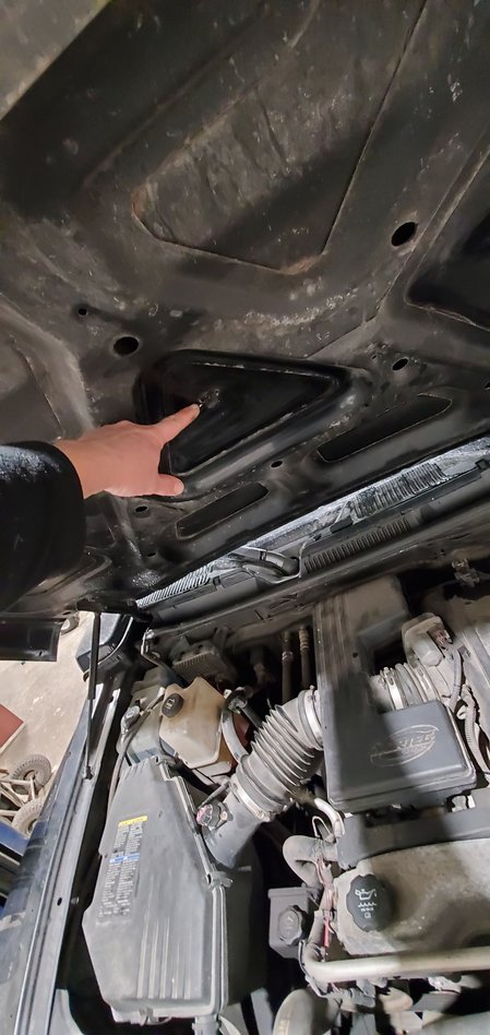

My driveway toward the garage is down slope, normally I park backing up., so I start to play with water throwing it on my hood, roughly copying the position when I park. Apparently the holes where clips go of plastic thing on the hood (see picture)letting water go exacly on the spot , where 1 cylinder position is. I guess after tomorrow ill get some silicone to fix the leak. That info could be useful for someone.

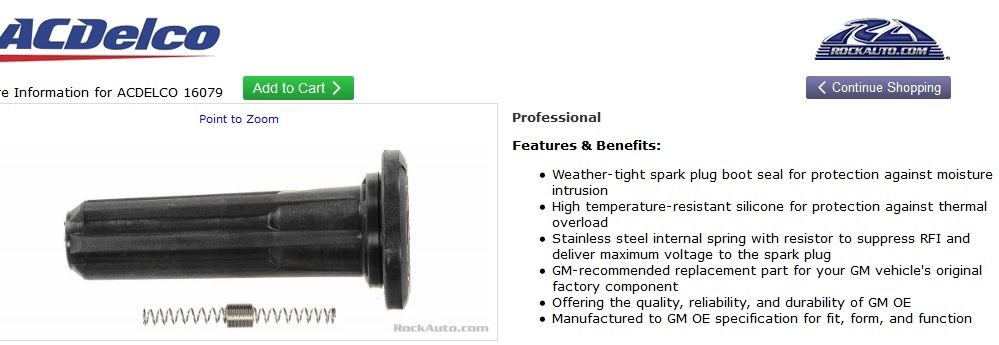

Time for a new set of boots. Spark Plug / Coil-On-Plug Boot
Yeah, at least for cylinder 1

Well, I tested it with water, putting the hood lid approximative in the position, when on my driveway... the water was licking from the middle clip, right on top of cylinder 1. Just Silicon in today, will check it now how it works...
