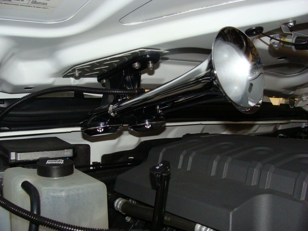

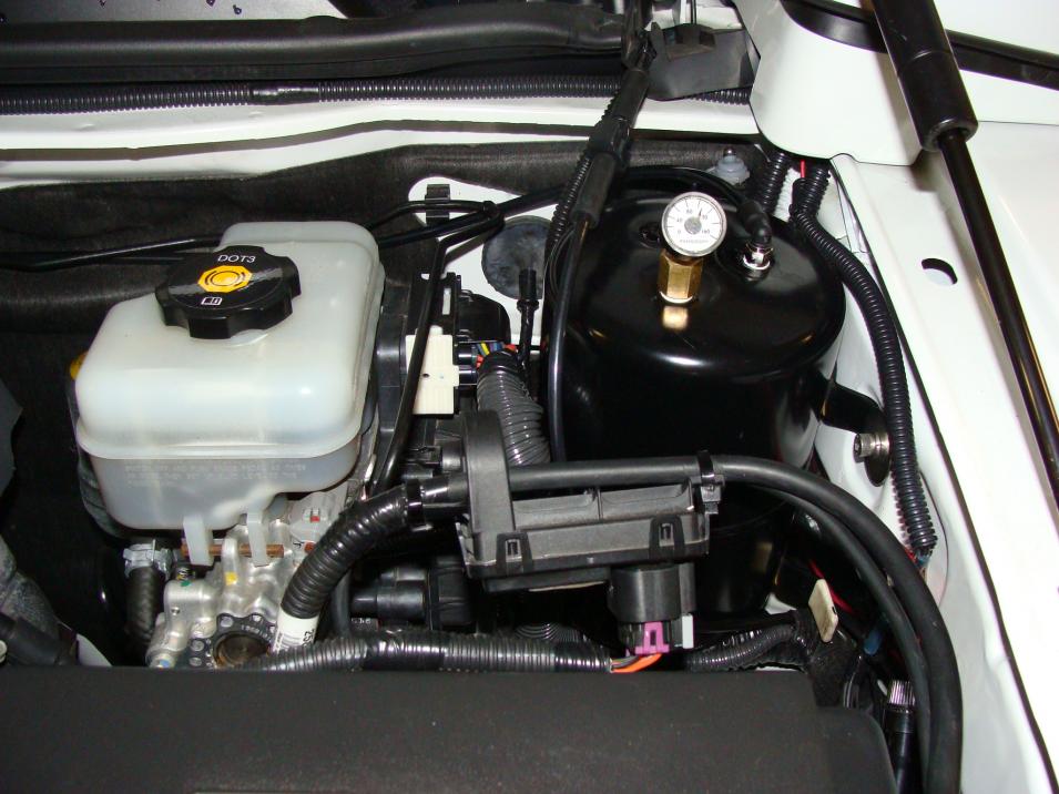

After several days of planning, measuring, making templates for aluminum mounting plates, plumbing, and wiring, I FINALLY finished installing my air horns. No more 'sick cow' under the hood. This thing sounds like a Freightliner coming up on you! Here's the web address for the Wolo Challenger kit. It includes everything you'll need...air tank compressor, hose, wiring, solenoid valve, and, as an extra bonus, a 20ft. inflater hose, so you can fill tires from the on-board compressor. Wolo model: Challenger 810 EV.
WOLO TRUCK AIR HORNS AND HIGH PRESSOR ON-BOARD AIR SYSTEMS

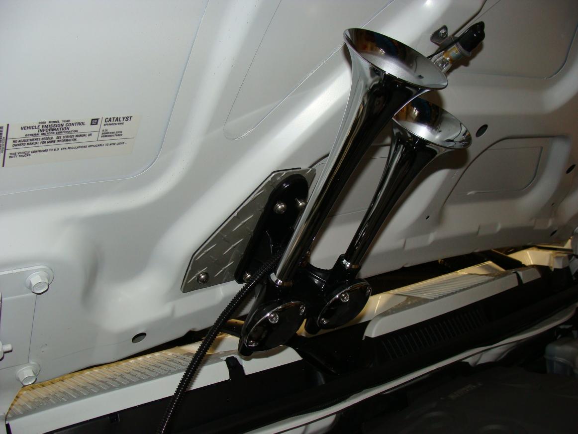

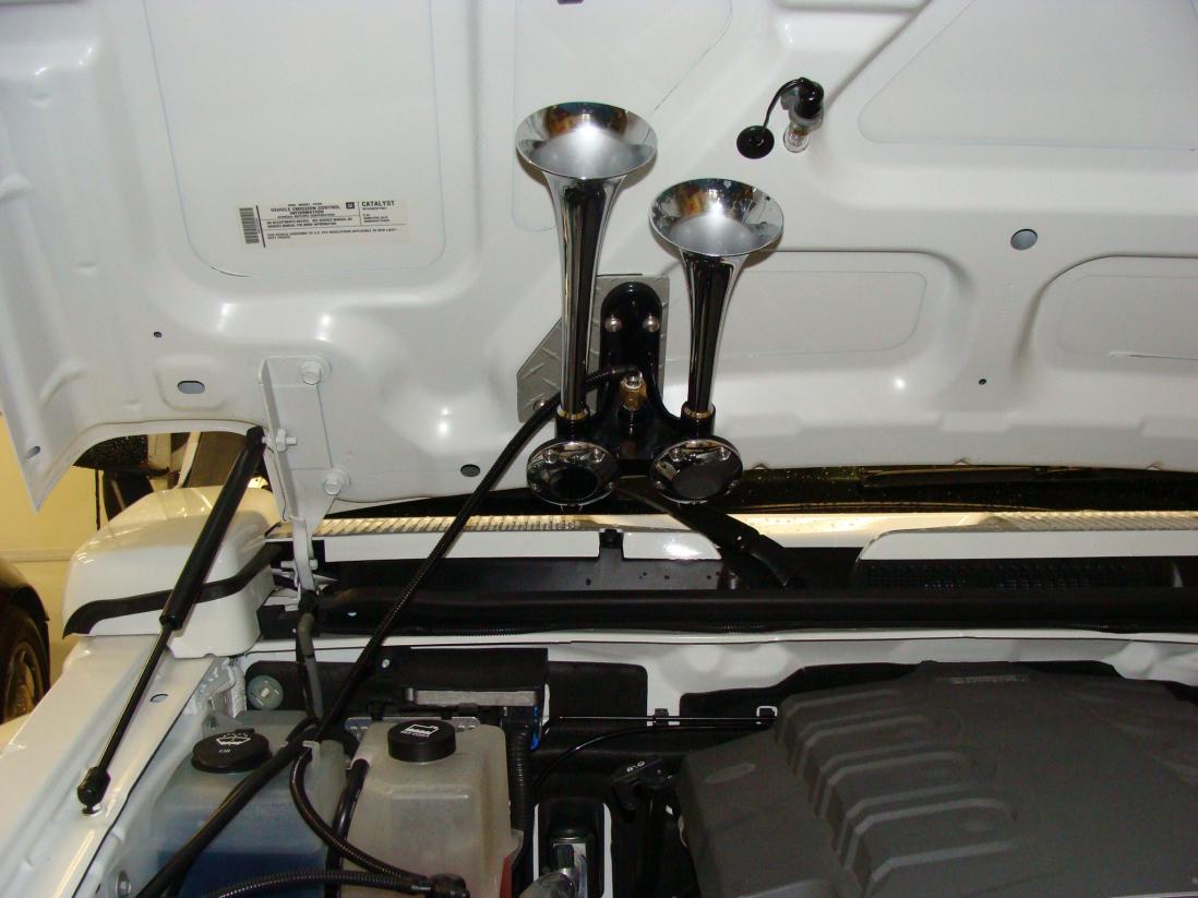

An update on this thread I started a few months back (original install pics at beginning of this thread). As loud as my air horn install was, 'too much is never enough'. I wanted to add a second set of horns, and an additional air tank, but couldn't find a way to get them behind the grill, and, there's little to no room in an Alpha engine compartment, so I started to think outside the box and here's what I came up with. When the hood is closed, the horns straddle the trans dip stick, and nest perfectly. Moving a few harnesses out of the way gave me the room for a second tank.

An update on a thread I started a few months back (original install pics at beginning of this thread). As loud as my air horn install was, 'too much is never enough'. I wanted to add a second set of horns, and an additional air tank, but couldn't find a way to get them behind the grill, and, there's little to no room in an Alpha engine compartment, so I started to think outside the box and here's what I came up with. When the hood is closed, the horns straddle the trans dip stick, and nest perfectly. Moving a few harnesses out of the way gave me the room for a second tank.
That is very creative, mounting the actual horns to the underside of the hood.
They aren't too muffled sounding under a closed hood ? Of course, I am assuming you drive with the hood closed
Just a really great install job
I just hope I am never in front of you and driving to slow

That looks great Broken Halo. I like that you mounted the horns under the hood. Did you have to machine any brackets or other hardware, or was it just a matter of checking clearances for stuff provided? I might want me some of that noise making potential.
Old Oct 20, 2011 | 05:26 PM
  #26
Broken Halo's Avatar
Posts: 1,461
I made the piece of aluminum diamond plate, with rubber backing, for the attaching base. The HARD part was being able to position the horn assembly so when the hood was closed, it cleared everything. Transferring dimensions from the engine bay to the hood inner was definitely a challenge. I didn't want to get it mounted and find out it interfered with something, and have to drill more holes. As it turned out, I only had to drill 1 hole, enlarge an existing hole, and install riv-nuts. But, with a tape, scale, laser, cardboard template, and measureing several times before cutting metal, it worked perfectly.
