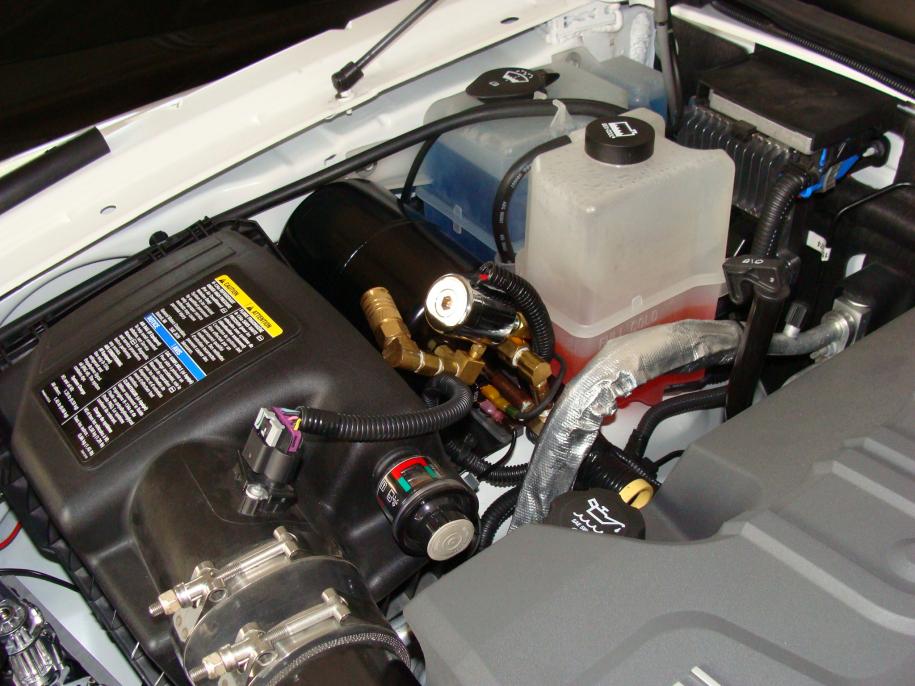

After several days of planning, measuring, making templates for aluminum mounting plates, plumbing, and wiring, I FINALLY finished installing my air horns. No more 'sick cow' under the hood. This thing sounds like a Freightliner coming up on you! Here's the web address for the Wolo Challenger kit. It includes everything you'll need...air tank compressor, hose, wiring, solenoid valve, and, as an extra bonus, a 20ft. inflater hose, so you can fill tires from the on-board compressor. Wolo model: Challenger 810 EV.
http://www.wolo-mfg.com/truck.htm
Attached Thumbnails Installed air horns....HOLY SH*T!!-dsc00531.jpg   Installed air horns....HOLY SH*T!!-dsc00530.jpg   Installed air horns....HOLY SH*T!!-dsc00534.jpg   Installed air horns....HOLY SH*T!!-dsc00535.jpg   Installed air horns....HOLY SH*T!!-dsc00536.jpg

Looks good, but, you may have a problem 'packaging' it. I worked with all the dimensions provided by Wolo, and started measuring. I even found a coffee can that approximated the air tank size, and used it to check for fit.
