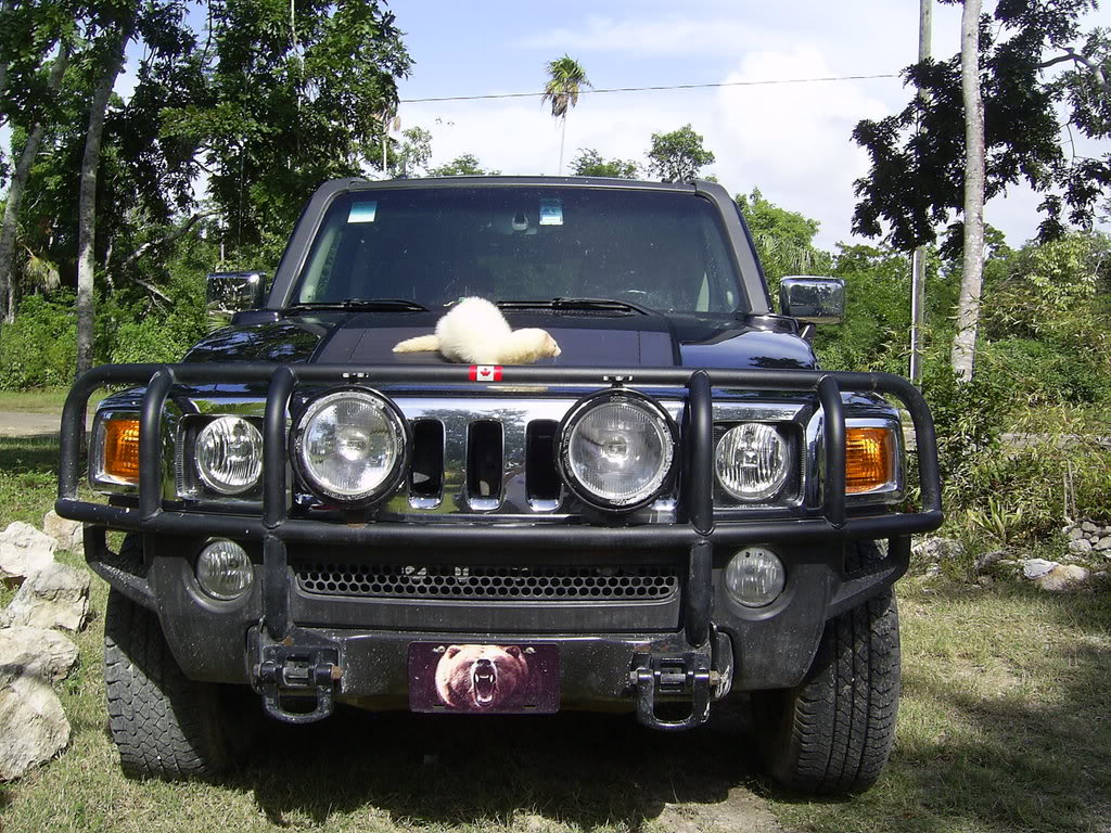

Well I thing I am ging to try the lift/leveling soon. I guess I will need a pair of 2" lift shackles for the back, and craink the torsion bar in the front up to 2 1/2 inches if I am reading everything right.
That should give me a 3/4" lift in the back and 2 1/2" in the front. The only bad thing about this is I have to buy shocks also. And I guess Fox shocks are only for non lifted trucks.
I guess it will be front Bilstein with reserve 25176407 Shock Absorbers
and back Bilstein 24-185615 46mm Monotube Shock Absorbers
Unless someone knows better.....

You should adjust the T Bar bolts (no cranking involved) so the front is no more that 23.5" fender lip to hub center in the front, whether that is 2.5" higher than where your 3 is now depends upon your current measurement. You do not need any new shocks if you do not exceed 23.5", that is a misconception perpetuated by OLD information when people thought you co go up to 24" w/o issue.
You of course can get new shocks if you want to.
