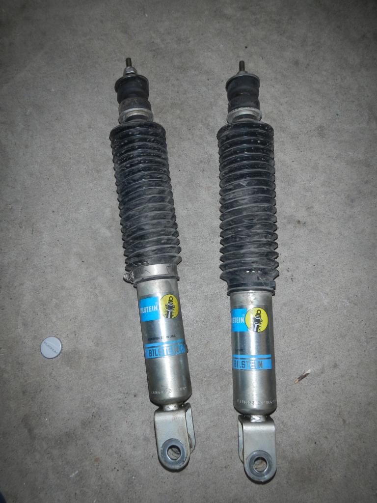

Well if it helps any I'm selling my "leave" 5100's shocks. Less then 10K on them for $130.
