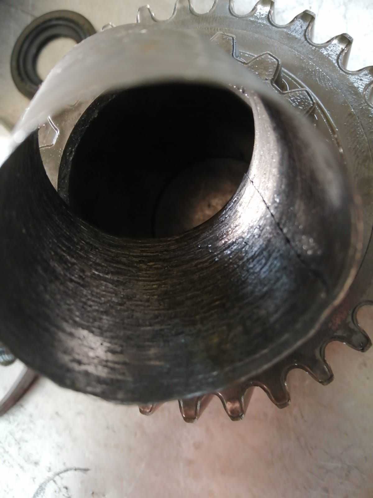

Cracked cased open, main input shaft bore trough sleeve that holds gears.
Rock auto has input shaft repair sleeve.
But, I can't find any place that sells input shaft, either I can't find it or there is none any more except full transfer cases.
Any tips where I can get just input shaft?
Other option is to get to buy used questionable quality transfer case and hope it is fine (Eastern europe).
Thanks and have a nice day.
Old Aug 18, 2020 | 03:15 PM
Posts: 3,217
maybe a machine shop can re polish the shaft and make you a custom repair sleeve
Old Aug 18, 2020 | 06:23 PM
Posts: 9,042
The damage occurs to the sleeve, why do you need to replace the shaft?
Old Aug 19, 2020 | 02:52 AM
LatvjuAvs's Avatar
Joined: Feb 2019
Posts: 115
Shaft has scratches and abrasion damage also, would just putting new sleeve on be sufficient even if shaft is damaged?
Old Aug 19, 2020 | 03:56 AM
LatvjuAvs's Avatar
Joined: Feb 2019
Posts: 115
Found shaft number,
Normal: 2.64:1 Ratio Low Range, NR4, input shaft - 89059536
For a sleeve there, looks like item "19168733" is similar, could not find in diagram sleeve for input shaft.
https://www.wholesalegmpartsonline.c...ssembly=392280
This site shows a price and pretends it is in stock.
https://www.wholesalegmpartsonline.c.../89059536.html
Old Aug 19, 2020 | 03:37 PM
Posts: 3,217
if you can just have the shaft repolished.
