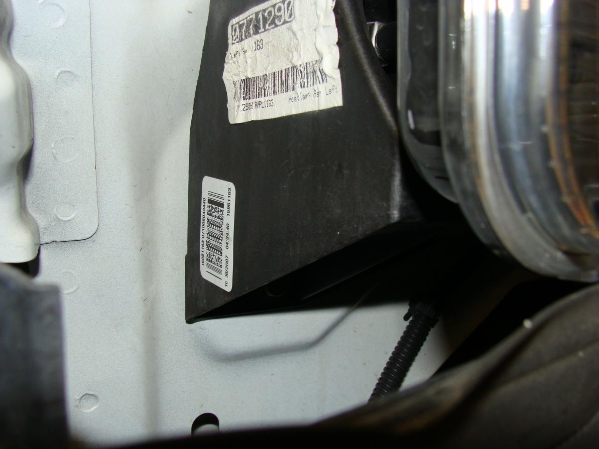

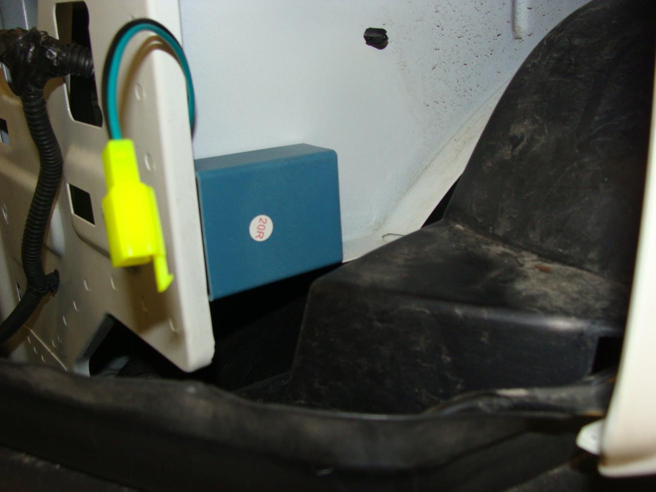

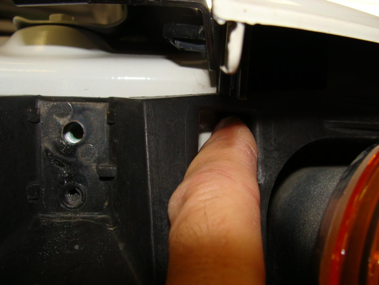

Just finished installing LED parking light assemblies, and front marker LED's. This was easier then removing the wheel well liners, and can be used if you're just replacing bulbs, or switching to LED housings. I decided to go with the LED parking lamp assemblies, and at the same time change the front side markers to LED's, to (hopefully), never have to mess with the PITA bulbs again. I didn't want to take the time to make a full blown PowerPoint presentation, so I took pics along the way, and I'll try to give instructions referring to pic #1, pic #2, etc. Start by removing the grill (I'm assuming by now everyone knows how to do that). The grill has to come off even if you go the route of pulling the wheel well liner, so this isn't an additional step. I'm working with the driver's side assembly, passenger side would be the same process. You can see in pic#1 (3) screws in between the headlamp and parking lamp, a 10mm & 7mm on top, and a 10mm on the bottom, (socket size). Remove these, and rotate the top bracket, pic#2, up and out of the way. There is a 3rd 10mm screw up and under the headlight. I couldn't get a pic of it, but look in the area shown in pic #3, and you'll feel it. Remove this. In the upper left corner of the parking lamp is a plastic tab, pic #4. Stick your finger in there, depress it sideways, and shift the assembly to the right and forward. Shifting to the right will disengage another tab that is to the left of the headlight. When you pull the assembly forward, you'll have to slightly flex the plastic body panel above the parking lamp so it will 'clear', and come out. Pic #5 is what it will look like when removed. Pic #6 shows the back of the parking lamp assembly where you can either remove/replace the bulb, or remove the (3) screws shown, and take out the whole assembly if you're switching to LED's. At the same time you can access the side marker bulb to switch to a LED. Pic #7 shows where I mounted the LED ballast with double back tape. Reverse the process to reassemble. Pic's #8 & #9 show my new LED's. Wasn't bad at all, and there's really no stumbling blocks through the whole process. Pretty much straight forward. Pic's # 6 - #9 continued in next post.
