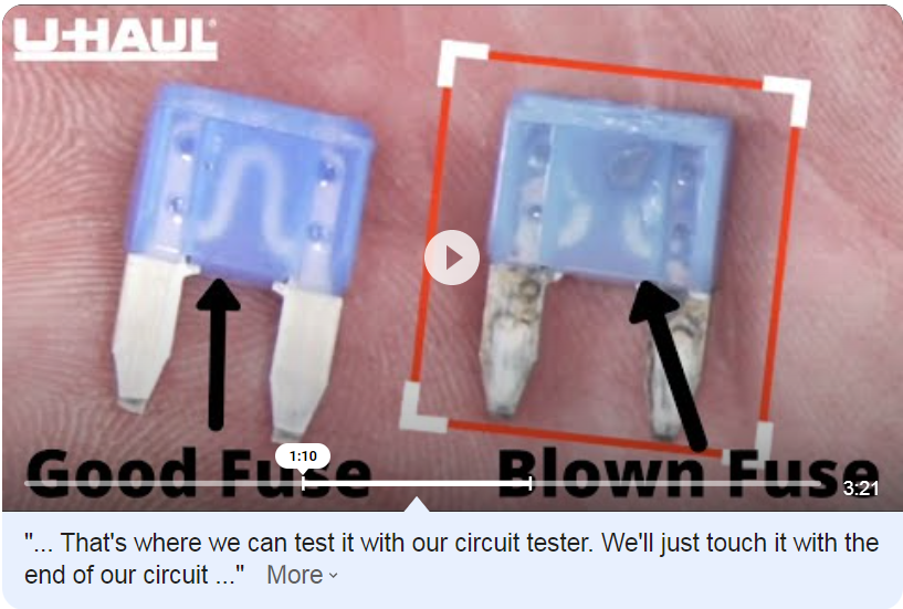

Default how to check if the R78 or similar fuses are blown
hello!
how do i check if my bigger fuses are blown or not? sometimes my 06' H3 does not start when i am trying to even though it cranks and turns but doesn't seem to start so i wait about 10 minutes and then it starts no problem, but now after waiting the 10 mins my driver side window wont work but all other windows work from their respective switches and the driver side panel also the unlock and lock switches don't work on both the passenger and driver side, i want to check if i have any blown fuses for the respective issues but one of them is the big square one and i don't really know how to check if its blown or not. if anyone could help it would be appreciated as i am new to working and self diagnosing my car and if anyone might have an idea if it isn't from my fuses id love to know.
thanks in advance!

To check a fuse just pull the fuse and inspect to make sure the fuse link is still visible and not open. Some of the bigger fuses have clear tops and you can inspect them without removing them.
