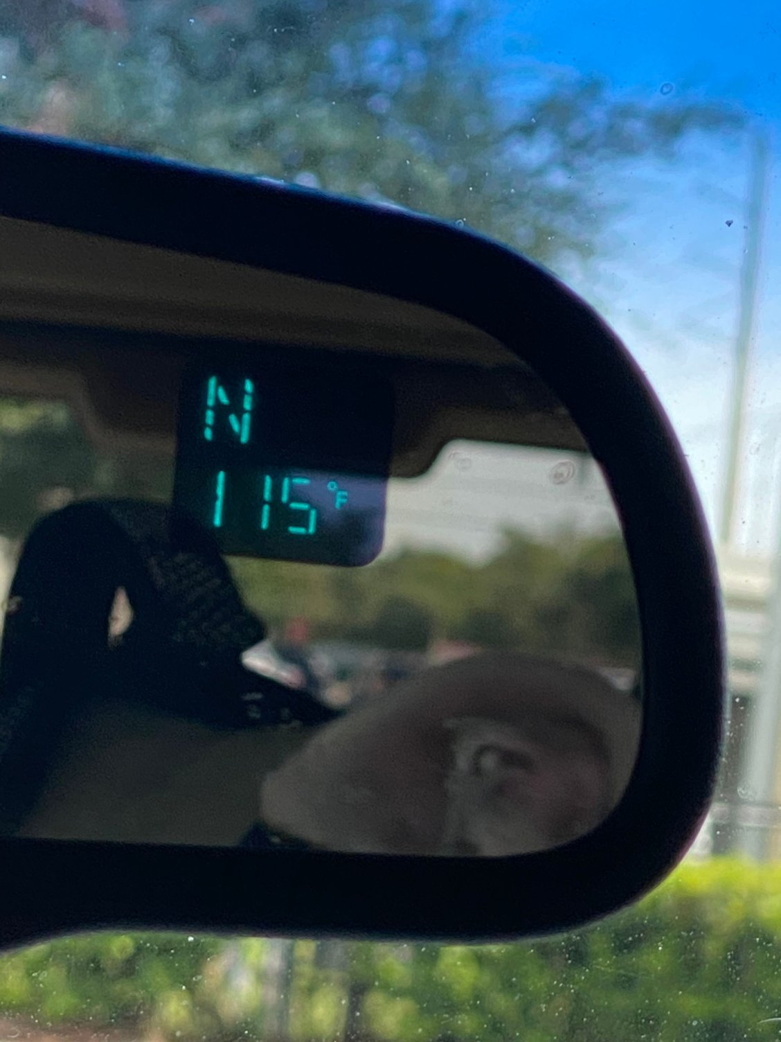

Hey guys, hummer finally runs great but I just want to make sure few things that are normal since I am not an expert.

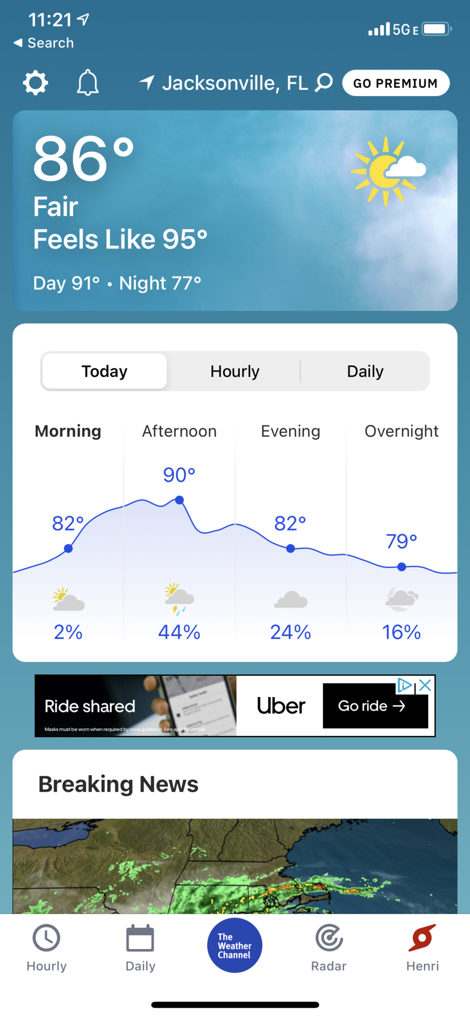

1-today is 85 degrees in Florida but it feels like 95. The mirror temp shows it’s 115F. While the car running on park my temperature in the car went to the 4th line of the engine temperature. That’s the first time I see it goes that high usually it doesn’t pass the middle . Is that normal? I know the radiator been flushed and inspected with the thermostats like 2 years ago

3/4 on the dash gauge is normal. It is not accurate enough to know what your coolant temp actually is, so you would need to use a scanner to see the correct coolant temp.

Ambient sensor reads temp from the grill, under the hood when parked high temp. Coolant temp gauge is high. Replace the>>>> 12601050
I replaced it and now I get 2 half/4 instead of 3/4
