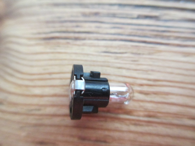

Hey thanks for the post it was a great help. I have an 08 H3 which has socket type bulbs in the HVAC instead of soldered in. Can anyone provide a source for replacement bulbs and bulb specs. Were did you come up with 12v 0.62w? I wonder if my bulbs will be the same? Dealer doesn't sell replacement bulbs but will be happy to sell the entire control unit for $400 bucks.
Thx
Attached Thumbnails Heater control bulb change. Dash removal-img_0031.jpg   Heater control bulb change. Dash removal-img_0032.jpg
Thx
check post #59...
https://www.hummerforums.com/forum/h...e6/#post306026

You can purchase the socket type LED bulbs from superbrightledcom. They are the 4mm. You may want to purchase the amber for the cool white look more of a blue tone where as the amber will tie into the dash better. Here is the link. Also test the unit before completely re-installing sometimes you may have to rotate the bulb 180 degrees for it to work. Good luck.
https://www.superbrightleds.com/cat/...r,NEO4,21,240:
