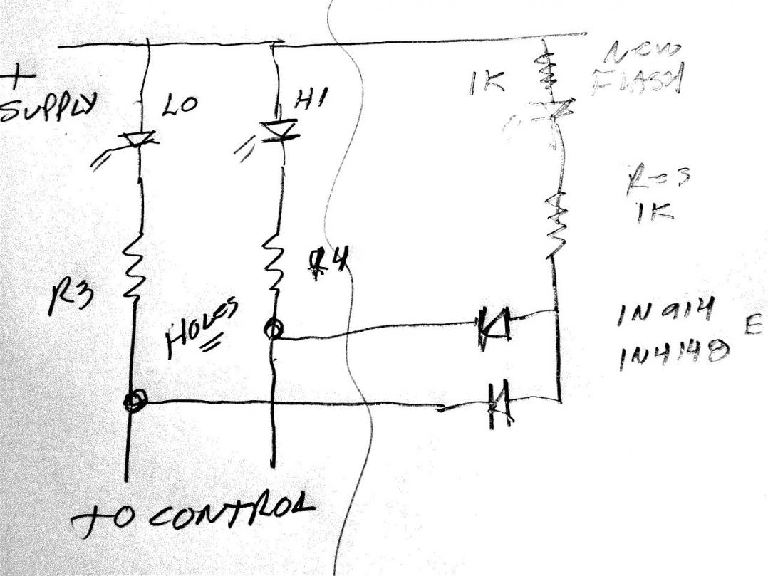

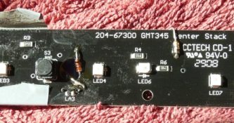

tnx for pics,,,here are 2, not too good but shows how to add a flashing led to warn of lock mode,hi or lo.
this ive used in 2 h3 and it keeps me safe.
the two diodes go in holes at r3 and r4,ez to find on board.
i suggest u NOT position them as i did in this pix. i did better later.
i scratched the insulation to solder to +volts. the flasher from radio shack.
the 2 1k res are redundant limit/protection
