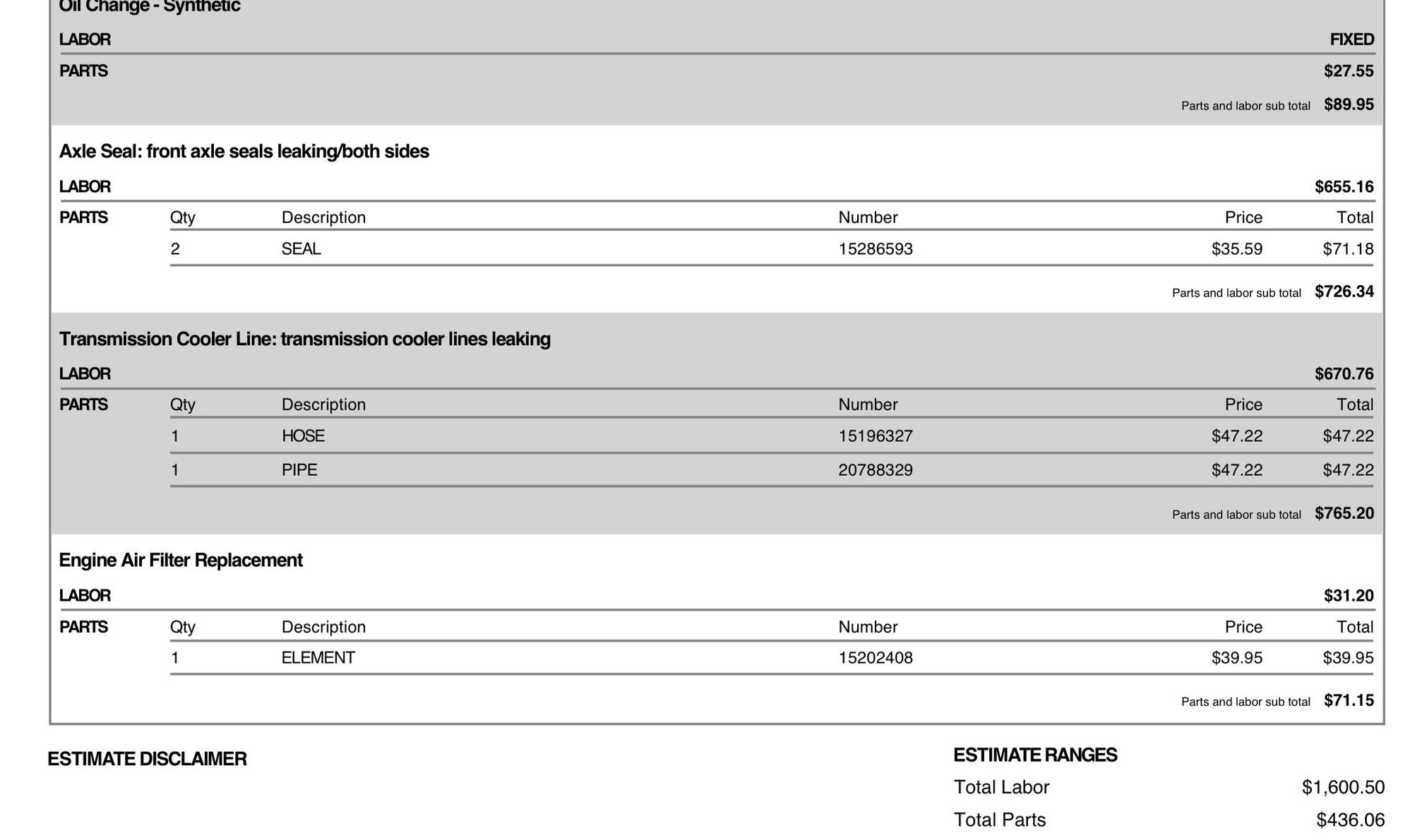

I was going to do oil change myself. Chevy dealer inspected and recommend fixing transmission cooler line and front axel seal that’s leaking.
it’ll be my first time, is that something I can attempt to do myself? They want $2k for this work.
