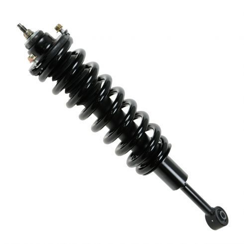

I was wondering if anyone has successfully upgraded their front suspension or steering lay out. My mechanic/fabricator friend and I are looking into upgrade my steering rack to a Chevy 2500 (will be trying to use 2500 steering box and gears as well) and hopefully swap out the H3 shocks with the front "coil" shocks (I don't know what else to call them) from an FJ Cruiser. Has anyone successfully done (or seen) something like this before? Or have any helpful advise on what direction to go? I'm also hoping to keep the T-bar lay out as kind of an assist with keeping the front end setup. I'm just trying to build the front end a little more stable.

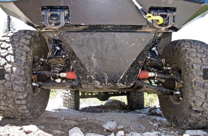

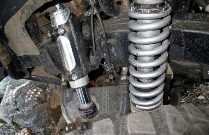

Without redesigning the entire front suspension AND front differential you won't get a coil over in there and around the CV shaft.

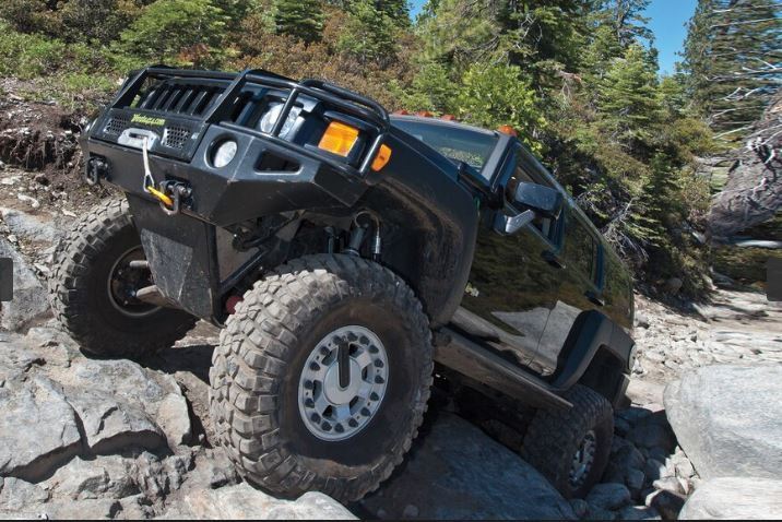

1 Full on long travel 4x4 Hummer H3 done and it cost a pretty penny.
Multiple Full on SAS/SOA H3/H3Ts out there now too. Price is dependent on what axles you use and the other components in the build.

I was afraid there wouldn't be many non custom options on getting a new style shock on there like the stock coil shock from the FJ cruiser I posted in the post. I may put a fork in that one for a little while until I could get some more info on custom things that may help along the way. With my MMW upper control arms, I found an FJ coil over would fit to the bottom front shock mount. But I find the mount is my obstacle right now. I don't know how they'd work either. I have high hopes on finding a solution. But if I don't, I honestly won't be disappointed. I may go full SAS if this goes nowhere.

If you just want to wheel some mild trails and a few small obstacles keep what you have and buy Outfitter Design parts. The best most reliable parts. They are also workign on a D44 & D50 front IFS center section. https://www.outfitterdesign.com/hummer-h3-kits.html
You have 2 options if you want strength and reliability to tackle above the mild Offroad trails. Don't mess with the little stuff and waste $ on fabbing up new ways to save the factory IFS.
In the end go full custom IFS/SOA or SAS/SOA. If someone would have told me this years ago I can't imagine how much time and $ I would have saved in the long run.
