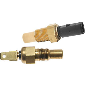

Replace the ECT sensor. GL
http://www.napaonline.com/Catalog/Ca...732_0306491251
Btw, make sure that dexcool is full and clean!

Because it is a common problem with your symptoms, and a cheap/easy fix.
You could go and buy some equipment to diagnose it yourself, or pay someone to diagnose it, however that cost alot more than the $12.00 sensor that you can install yourself.
If your vehicle starts to use a lot more gasoline than usual, or black smoke is starting to come from the exhaust pipe, these are indicators that the coolant temperature sensor in your vehicle could be defective, and needs to be replaced. If you start having trouble starting your vehicle or runs rough after it has reached its normal operating temperature, this is usually a very good sign that you need to have the coolant temperature sensor checked.
Btw, your gauge shows lower than normal operating temperature for the H3!
Also, the ECT sensor controls alot more than the gauge, and it couldn't hurt to replace it, even if it does not correct your issue.

Just checked part info. The 1 I listed above is for the alpha..
The I5 is a different part number acdelco 213-4233 (gm # 12601050)
ACDelco OE Service Engine Coolant Temperature Sensor Cool Temp Sensor | eBay
Napa ECH TS5748
http://www.napaonline.com/Catalog/Re...Dp%3d3%26N%3d0
