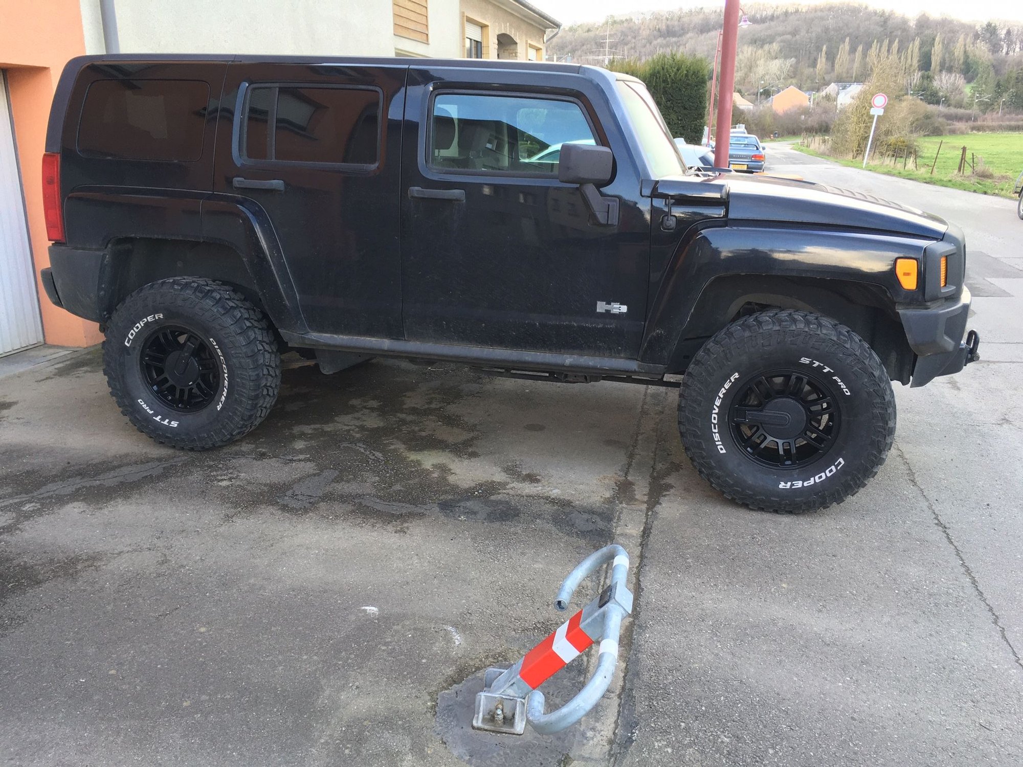

H3Luxembourg's Avatar
Joined: Jun 2011
Posts: 307
From: Luxembourg EU
Howdy, well I had the same problem and finally, got my OEM 16" sand blasted and powder coated in satin black. Love the result an for less than 1000$ here in EU. Sure you finde that in the US.
