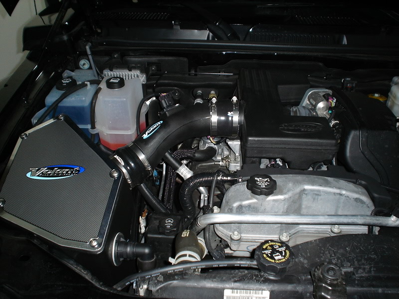

If I hadnt JUST ordered my air intake from VOLANT...Which i still havent gotten yet since the SAWP OUT on wrong part....I would have ordered one of yours...Maybe i can call VOLANT and STOP my order...so this fits my 07 H3 3.7???? seeing the pics above...I dont have that pipe going to the value cover,,,Do I????
Yes you do have the valve cover emission hose, but Volant does not replace the throttle body resonator box. The valve cover breather hose connects to the bottom rear of that box, our system just connects to that stock hose once the box is removed. Now why anyone would go to all the trouble to replace everything else, and leave the restrictive resonator box in the loop is beyond me. Here is a pic of the Volant intake so you can see that big old honkin resonator box is still in place??
