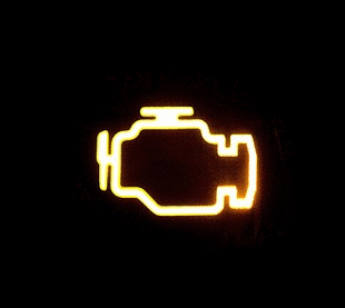

So, when a passenger gets in the front passenger side seat, the amber EML light comes up on the dash. As soon as they get out, it goes off and doesn't come on any other time. It's very strange. I guess it must have something to do with pressure sensors or something in the seat but why it makes the EML light come up I really don't understand.

you mean the check engine light turns on when someone sits in the passenger seat?
or is it a SRS light?
on my H2 i have a switch to disable the passenger air bag that turns on a light on my dash switch.
Old Aug 13, 2023 | 03:51 PM
EU: EML (engine management light) US: CEL (check engine light)
Steady On(safe to drive) or FLASHING(need to diagnose/repair ASAP)?

yeah it's the EML/CEL light coming up when someone sits in the passenger seat. The icon that's been posted below. When they get out of the seat it goes off. It's a steady on light not flashing.

thanks for clarifying that it's called something else in the US. It's on steady, not flashing, when someone sits in the front passenger seat.
