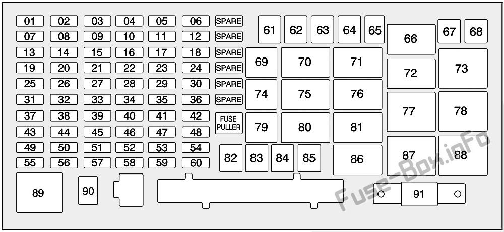

Swap relay #66 with #72 & recheck.

I just swapped them and still didn't start. I did notice one was 0329 and the other 0330. I swapped it with another 0329 relay and didn't start either.
