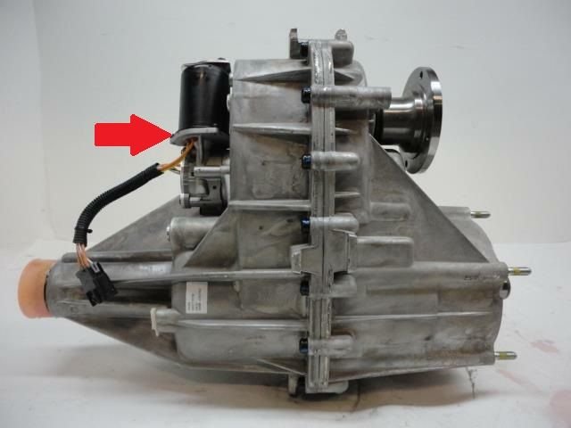

I have a ‘07H3 with 89K miles and the 4WD differential will not cycle and I think the servo motor is not working.
Where is it located and how difficult is it to replace?

what you ask for should be on the transfer case not on the differentials. some have removed them and cleaned then re-greased it and put it back. sometimes it just need to be replaced. not too hard to access looks a bit like a wiper motor stuck to the side of the transfer case.

What you are looking for is the 4WD Transfer Case Actuator and like bronxteck said it is mounted to the Transfer Case, looks like this (#12 in diagram). Check the wiring to it and clean both sided of the connector with CRC Electronic Cleaner before you replace what ain't broke.
