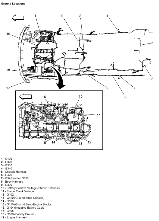

It is a 2008 with 95k miles. Thanks for tip on the battery terminal connectors, those are good right now. I've changed the bulbs and put dielectric grease in them during the process. Where are the rear brake circuit grounds located is there a good diagram of this? I will inspect those tonight if I can locate them and see if there is a loose ground bolt perhaps. Not sure best way to inspect wires past the pigtails coming out of the rear fender either. Perhaps pull the inner fender liners?

Ground for rear lights is position G420 (near license plate wires) #6 in the below diagram.
