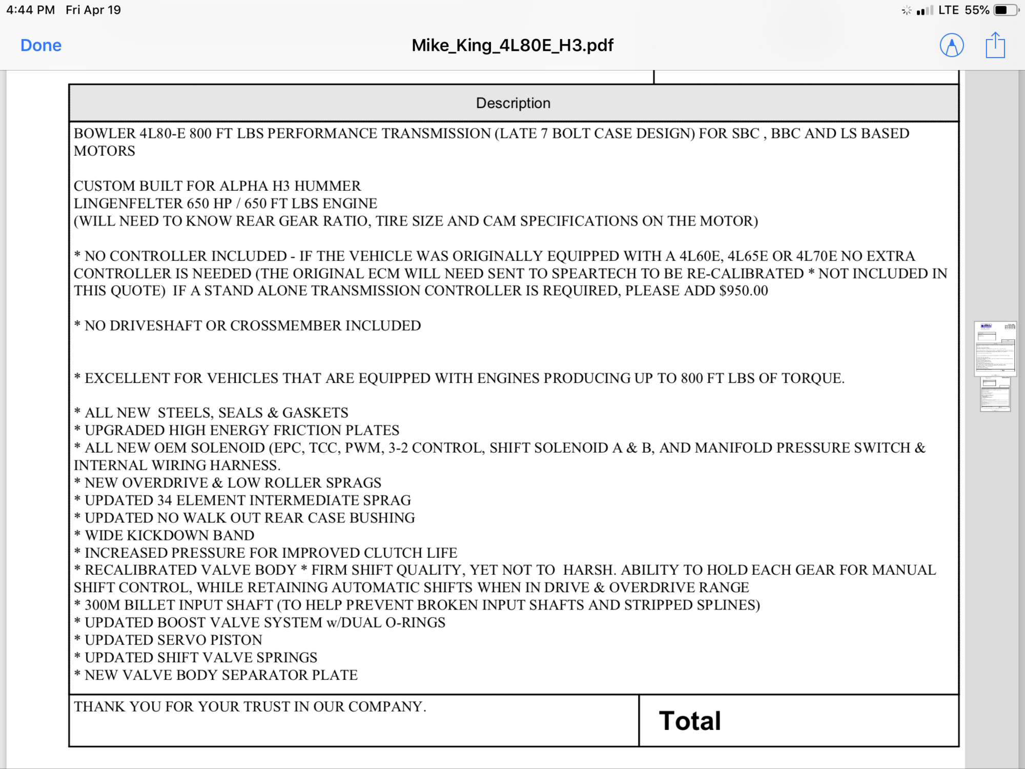

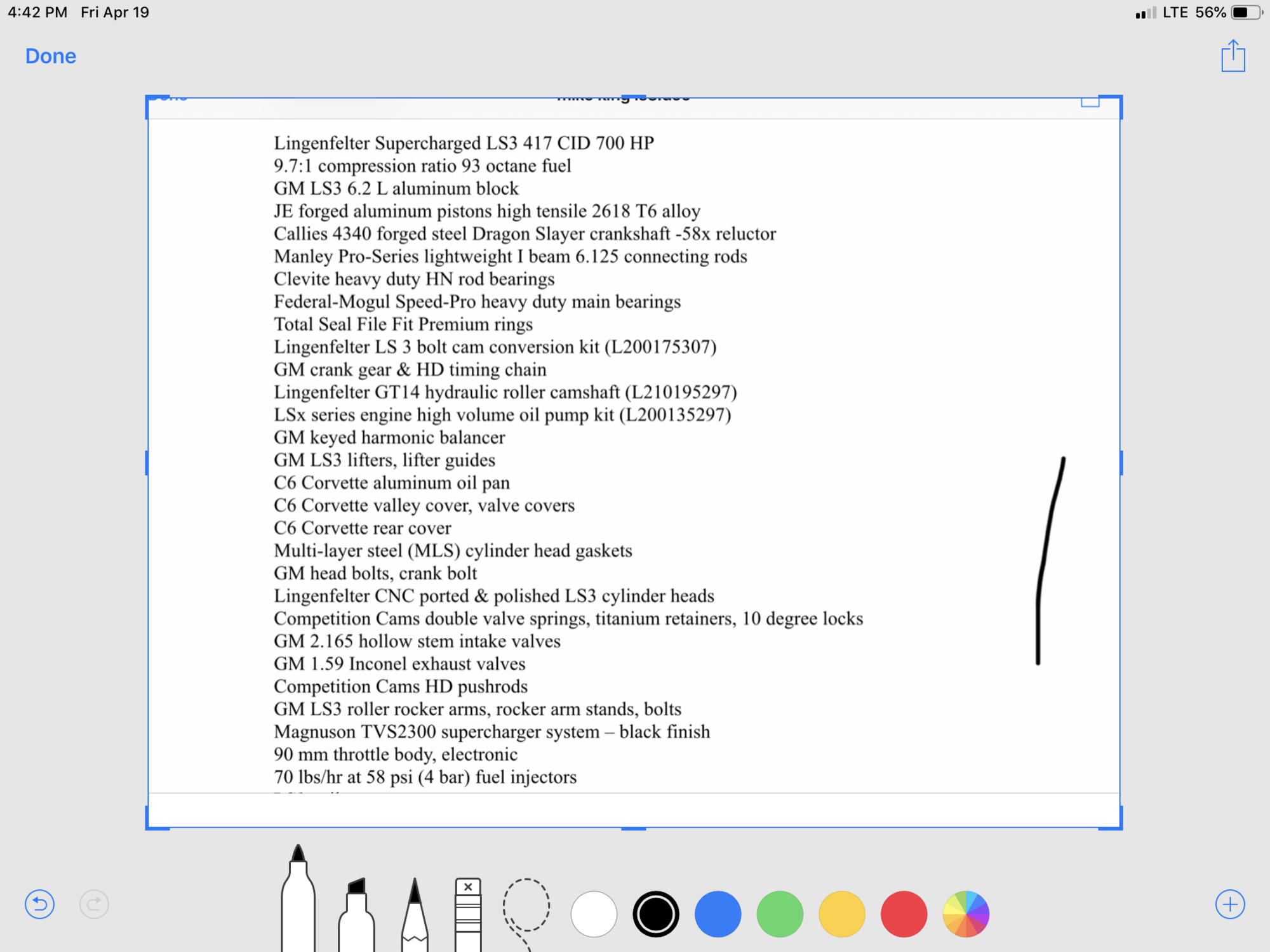

Default Some Specs on Alpha Dog
Old Apr 19, 2019 | 03:52 PM
Bone's Avatar
Joined: Feb 2018
Posts: 18
The ride and drive is awesome!

Used both the factory ecm and tcm! Don
