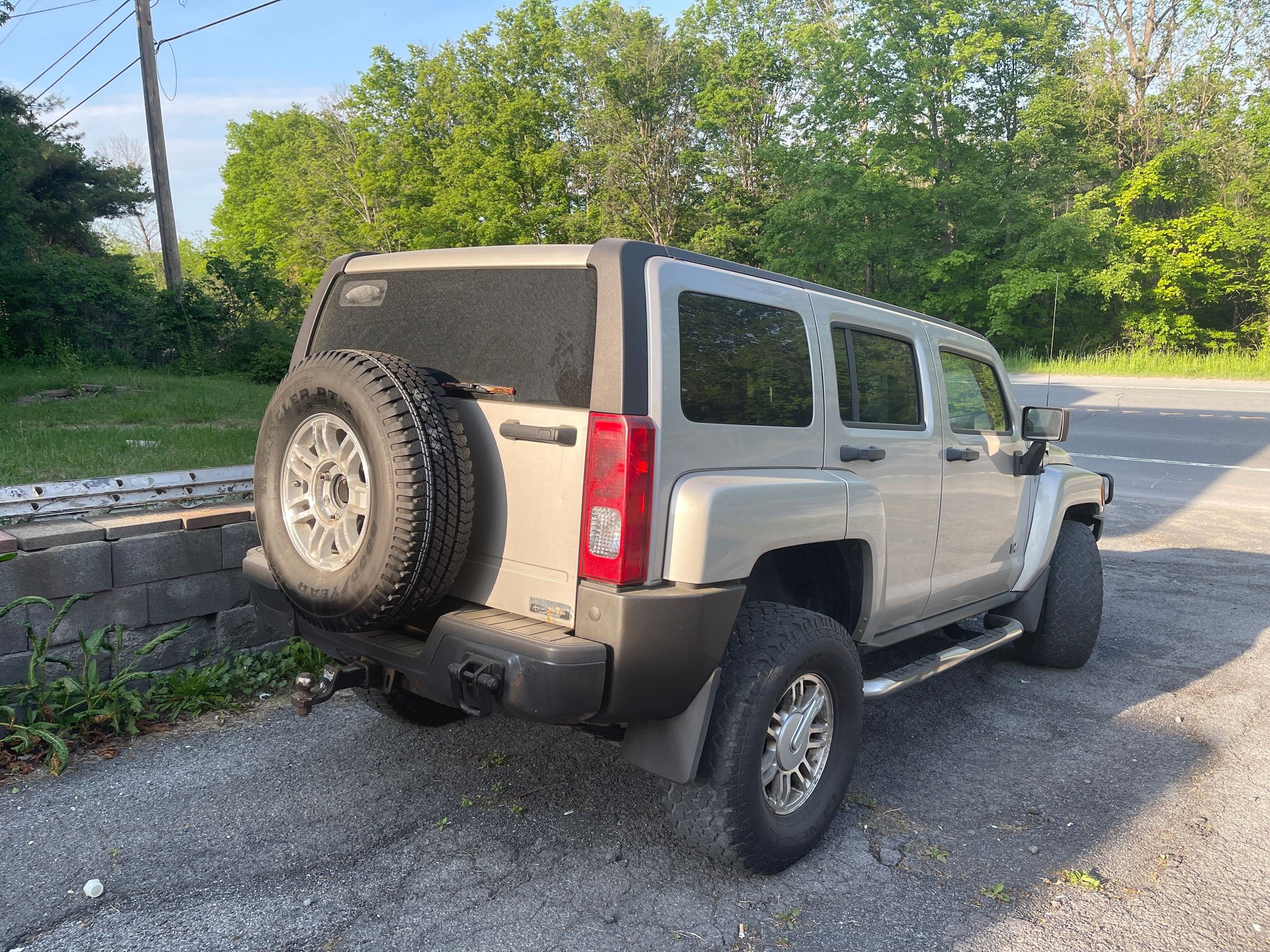

So I went to test drive, he is a retired car salesman.
It starts fine, engine looks good and clean he says the
engine is a replacement and has 94k. Though it reads 139k.
While driving I was listening for the transmission- but I can’t tell, it seems to shift smooth, but everytime I lift
my foot and hit the gas I hear like knock/jerk if I can describe it that way. What could that be? He is willing to lower it to $6.5k, it definitely needs new tires.
Any thoughts appreciated

Have you ever driven any 4X4 GM truck before? Drivetrain lag is what you are describing, and that would be normal.
H3s have a Transmission, Transfer Case, front and rear drive shaft, front and rear differentials, and front half shafts. When you let off the gas, all that unloads torque and as it does you can feel/sense a minor clunk, that goes away as soon as you step on the gas to apply torque load again. I have owned maybe 18-20 4X4 GM trucks and every one of them did that from brand new until I sold them.
If it is more than a very minor clunk, could be U Joints need to be replaced, but you would hear those when shifting from drive to reverse as well and could feel the play by getting underneath and twist the drive shafts back and forth.
