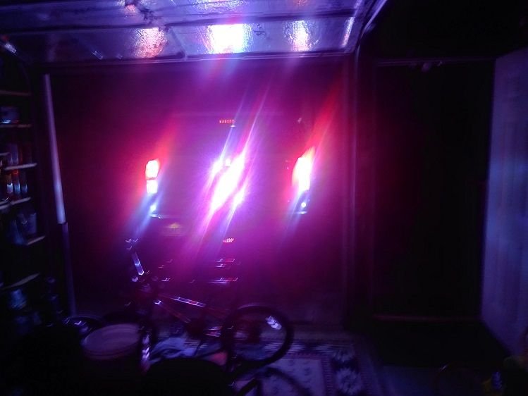

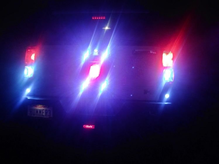

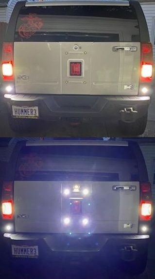

Close to dark. Only reverse lights/ plus lights on the cargo door:
ALL lights on:

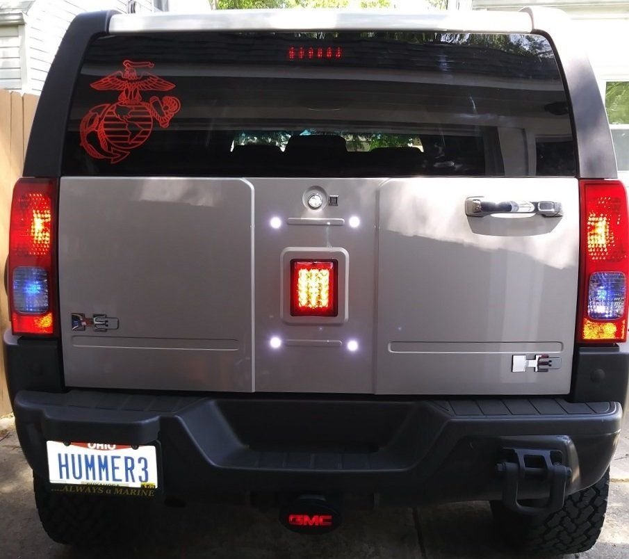

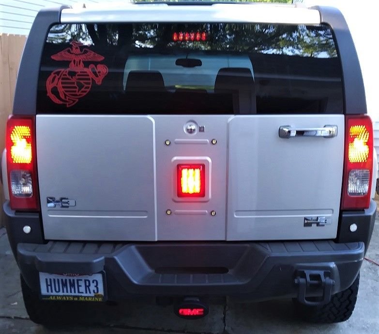

Added a GS-100A flash controller to the cargo door brake light, and changed the brake light bulbs to 144SMD 3157 6000k

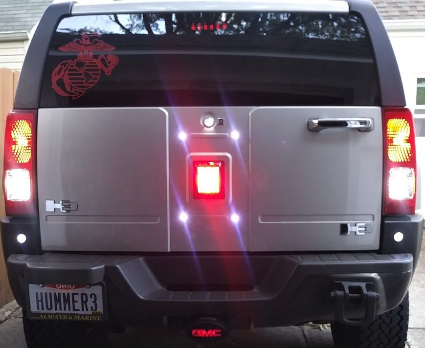

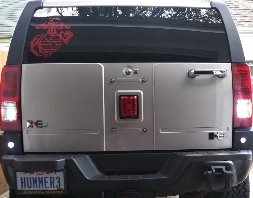

My madness continues.... After, I replaced the incandescent 3057 brake light bulbs with 144SMD 3157 6000k
I noticed the brake light bulbs were 2x+ brighter than my replacement reverse 8w 3157 33SMD bulb.
So I ordered another set of the
144SMD 3157 6000k to replace the previous updated 33SMD reverse light bulbs. I like the way it looks now, bright as, if-you-see-kay.
Picture showing 1-33SMD with 1-144SMD reverse bulb:
Pictures showing before and after the 144SMD bulbs installed:

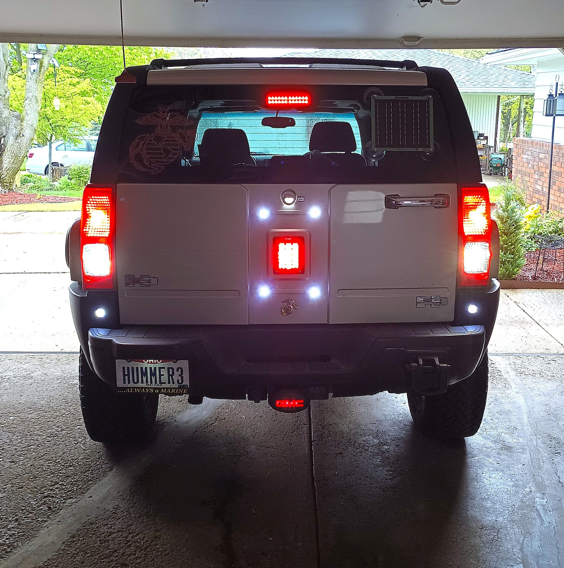

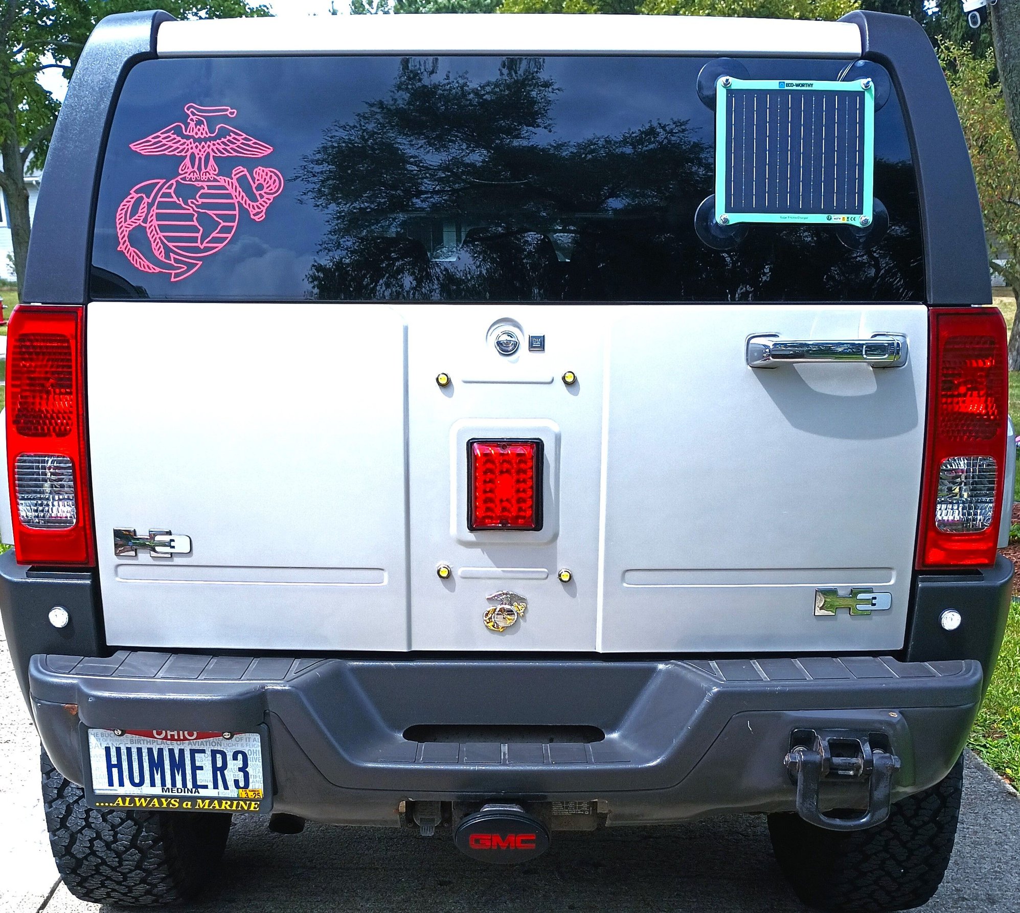

7.5 inch Aluminum Housing Red Stop Brake Turn Signal LED Trailer Lights 24LEDs :cool: 7.5 inch Aluminum Housing Red Stop Brake Turn Signal LED Trailer Lights 24LEDs :cool:

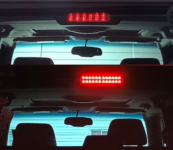

Years back I installed 2 led strips into the high mount brake light, however not bright compared to my other brake lights.
I gutted the housing front & rear then installed this light on the front with 2 screws after drilling pilot holes then remounted on the upper door panel.
These lights have 3 wires White=Ground- / Black= +low light / Red = +high bright light. I only connected to the high mount original wiring blue to red & black to white.
Huge difference in light output viewing in person compare the before>>>> after:
