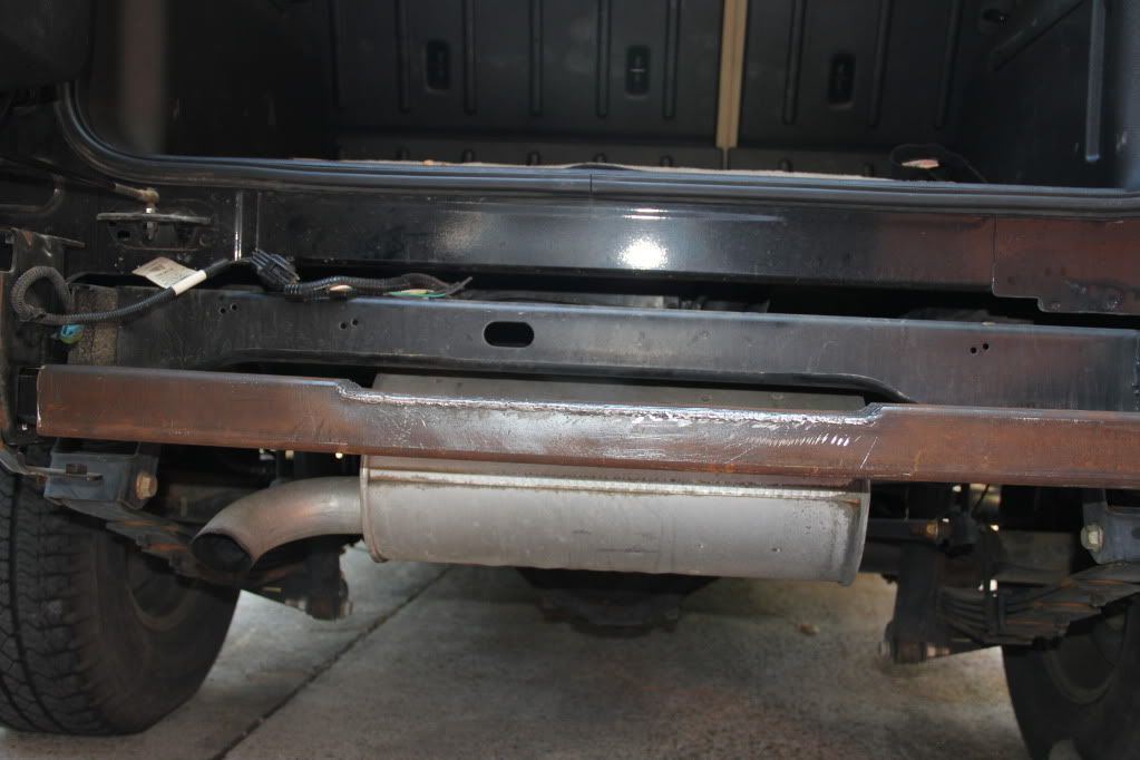

Check the trailer wire harness between the rear bumper and the frame.
The wires sometimes get frayed and intermittently ground.
There is a great photo on HF somewhere of the exact position. FOUND ONE!
underneath behind the bumper, no need to remove the bumper. Photo is for wire harness location only.

Forgot to mention that, I did get under rear bumper and looked. It looked all good to me...thank you
