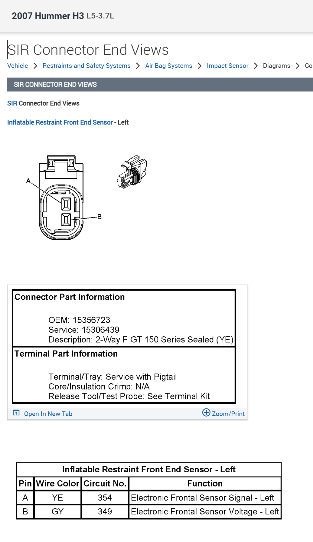

I personally would be weary of splicing in a new connector and using them. If you could share the year and motor of your H3, I can pull up the wiring diagram for you.

Thanks, the issue is my 2007 H3X 3.7 front impact sensors are no longer available part number 10383628 I have found ones for a 2008-2010 i believe but the slots on the plug are in opposite sides of mine. The plug is the same two wire for both sensors. The guide or whatever those tabs that guide it in are what is different.

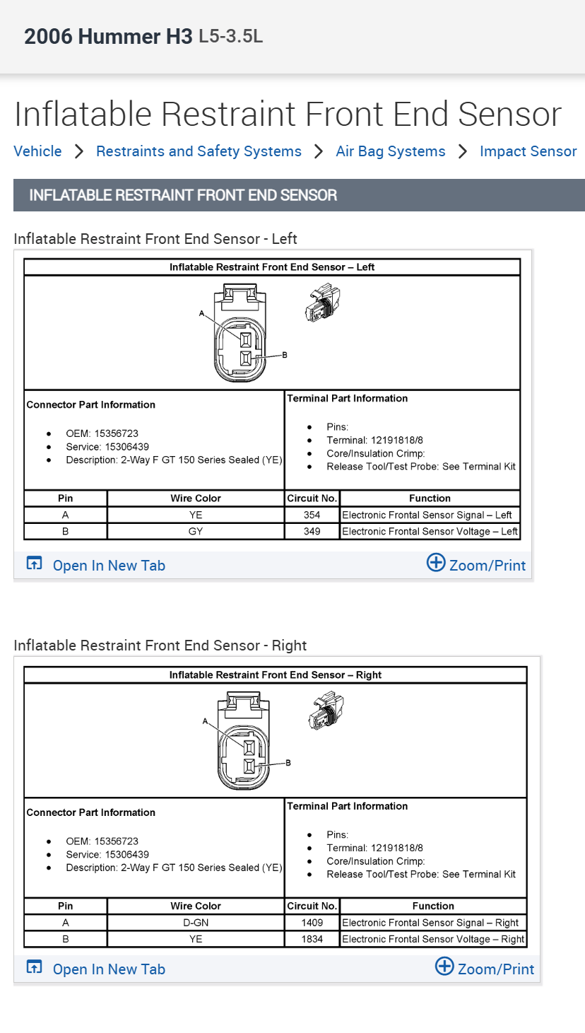

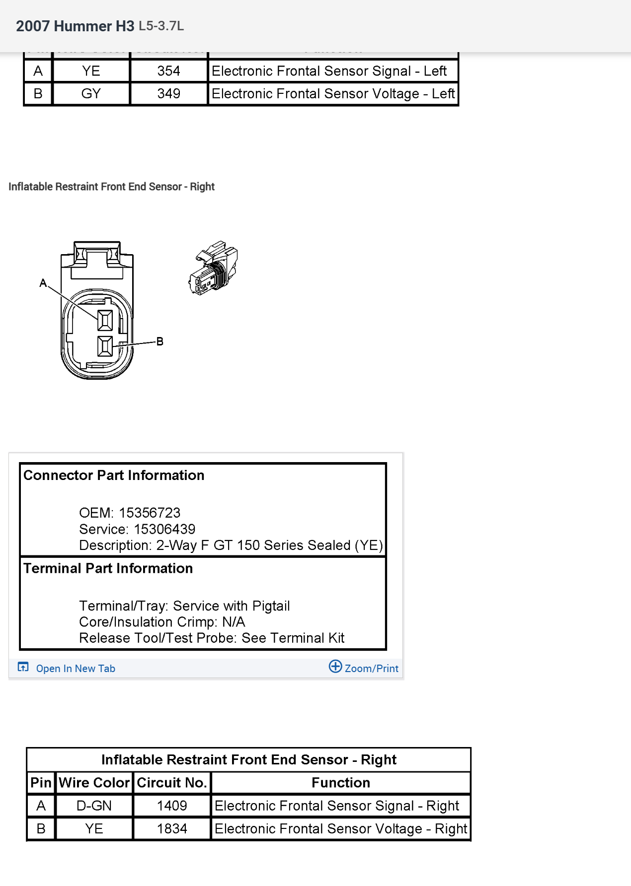

When I look up 15254201 it shows that it is only for the 2006 model.
The connectors look the same though. Here are the connector views for 2006 and 2007. It may work, but I was able to find quite a few available units on ebay with the proper part number.
