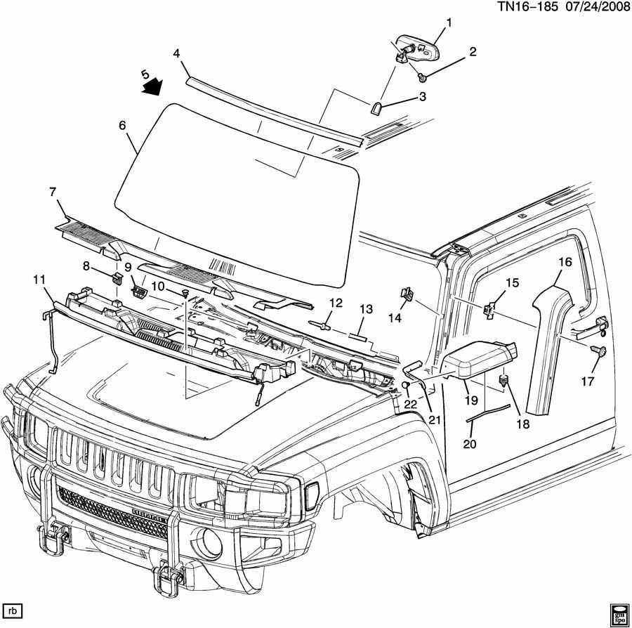

Can anyone tell me where to find the offwhite clips that goes to the Hood front fender air inlet cowl?

Go to any GM online parts supplier and fill in the drill down. Might have to take what you have (from the opposite side) and scrounge the auto parts for something close enough.
If you are looking for #18 below, me thinks that is going to be hard to find, might not even be available any longer? Let us know if/when you find it.

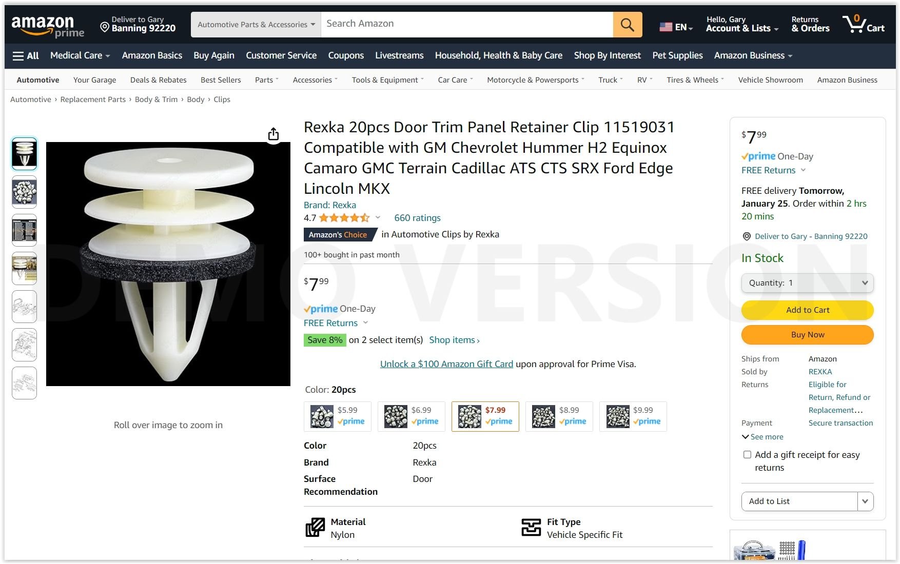

Lots of suppliers on Amazon
Here's some. Here's some.

Yes it is number 18. As always Doc you help is appreciated. Will post my findings!🫡

As I said, they are available on Amazon; multiple sellers. And yes, these are the correct ones; I've purchased them for the hood cowl on my H3.

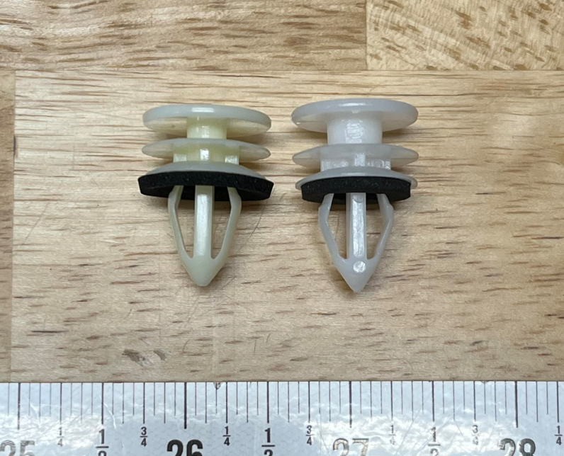

Your post mentioned "off-white" and 650Hawk included a screenshot of the correct replacement clips so it seems like you are good to go; however, I did want to point out to anyone else who comes across this thread that there are two variations of these trim retainer clips and they are not interchangeable. You can see in my image below that the off-white clip (left) has equal spacing between the top, middle, and lower round pieces. The pure white retainer clip (right) is nearly identical in size but there is a larger space between the top and middle round pieces. I can't remember exactly what I needed them for, but I ordered the pure white retainer clips by accident the first time and found out the hard way how much difference that spacing makes.
I just verified that the clips the OP needs for the air inlet cowl are in fact the off-white clips with equal spacing but for anyone else out there, just be cautious when buying them and make sure you are getting the correct clip the first time!

Thank you for this infor. I took 650’s advise and ordered the ones he posted. They should be in today. I will post the findings.
