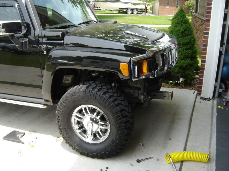

What are the cutouts on the front bumper...Not the Center on, but the 2 that are on the ends under the turn signal. Does anyone know what style and brand of lights i could mount there?

I have always wanted to put lights or something there as well.

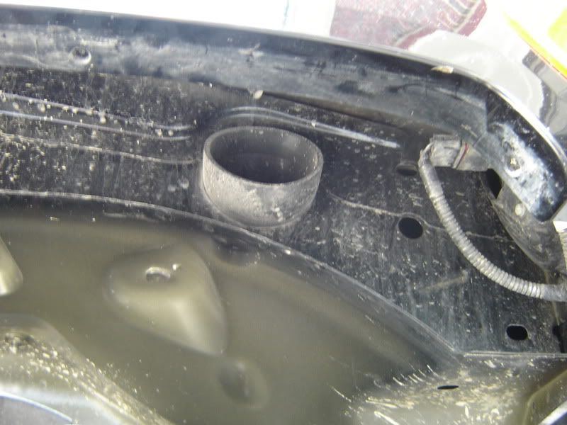

The cutout on the right side, under passenger side turn signal is the air inlet for the airbox. I wouldn't block it unless you've installed a snorkel. I'm assuming at this point you have not installed a snorkel.
Old Jan 2, 2019 | 09:04 AM
Posts: 13,113
Irrelevant to intake air, and the opening in question is below the outer fender liner. The air intake system pulls from in between the inner fender and outer fender liner, which means air can come from top, bottom, rear, front or anywhere like around the headlight.
Air Doc Intakes H367 Inlet Snorkel with outer fender liner removed.
BA Winch Bumper, no outer holes.
NO outer holes. Great spot for more lights.
BTW, Thanks, Doc. I didn't think those had anything to do with intake air.
However, quick question. How much room is there, between the opening in that snorkel and the fender liner? Doesn't look like much. Unless, it sits above the top of the fender liner?

Posts: 13,113
EJ
The pic is from below looking up, you might be referring to the fender lip. There isn't anything near the intake inlet. Basically pulls from a big empty box that is the space in behind the fender.
