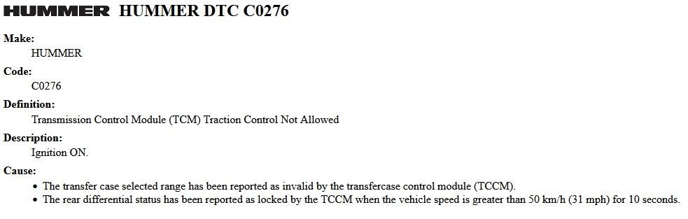

Was getting error message for ABS/TC/4WD. Inspected connections-nothing. Pulled the TCCM & cleaned it inside & out. Reinstalled TCCM. The code is reset & has not come back (so far ~ 4weeks)
