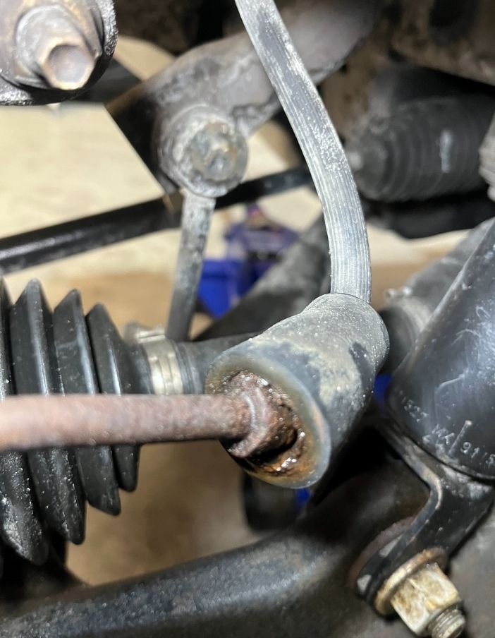

Not to beat a dead horse, but are you 100% positive the brakes are fine? Not just the fluid level in the reservoir. You get down and check all the brake lines for leaks or cracks? Have you noticed any difference in terms of the overall depth when you depress the brake pedal? All of those messages cycled through when my front driver's side brake hose essentially disintegrated back in January. When you say "brakes were done about 5 years ago," what exactly does that mean? You had the brake pads replaced? Pads and rotors? What I'm trying to say is in an instance like mine, getting new brakes and rotors installed has no bearing on the structural soundness of other components like the high pressure brake hose. One might think that a mechanic would notice an issue with your hose(s) and alert you but that issue might not be noticeable right away. I've included two pictures of my failed brake hose below which might help paint the picture. The joint/connection where the metal piece mates with the flexible rubber hose is covered by a bulky protector that I had to cut out with a box cutter just to be able to see the severity of the damage. At this point it's pretty obvious for anyone to see that I likely had a looming issue with this hose for quite some time, but I promise that all of the problems I had with the brake pedal/leakage/warnings on the dash materialized in one day.
I consider myself to be fairly observant and in tune with my H3 as most others on this forum likely are as well, and I did not notice a leak or a drop in the reservoir until the morning it all came down on me. Again, I'd get down on your back if possible and go check all of those brake hoses to try and rule out a leak. You probably won't be able to inspect underneath the rubber cover that goes over that joint, though. Good luck tracking down the issue.
