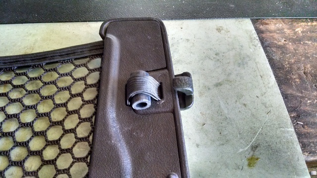

Like many, the nets on my seatbacks were loose, and fell off easily whenever rear seat passengers bumped into them. The elastic strap attached to the hooks are just stretched out, and so they hang loose.
I had tried twisting the elastic straps to tighten them up, but that didn't really work, and the hooks didn't lay flat. After looking at them, I came up with a cheap easy fix that anyone can do.
Pop them off (really easy in the "loose" condition ), and then take a piece of rubber hose (I used 3/8" diameter, but you can use whatever size is needed to tighten them up sufficiently). Cut 8 pieces (4 for each seat) 3/4" long, and slip them under the elastic strap on the back side.
Reinstall them. Done! The hooks now hold the pieces tight against the seatback, and still allow some give.
