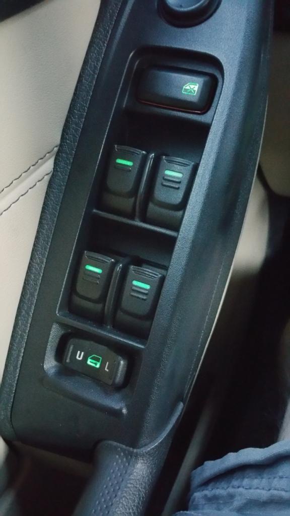

👋 Hi , I have all my door switches working fine but have no illumination lights 😕 changed the bulbs & still not working .
is there a wire or fuse that I need to check ?
Ahmad

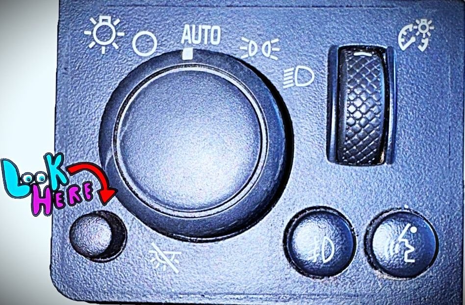

Posts: 9,046

This button is for the curtesy lights .

Posts: 9,046
What "no illumination lights" are you referring to?

the door switches are working but doesn't have illumination.
Old Mar 28, 2025 | 05:00 PM
Posts: 9,046
Does the Ambient Light Sensor work?GM Part # 15174892
