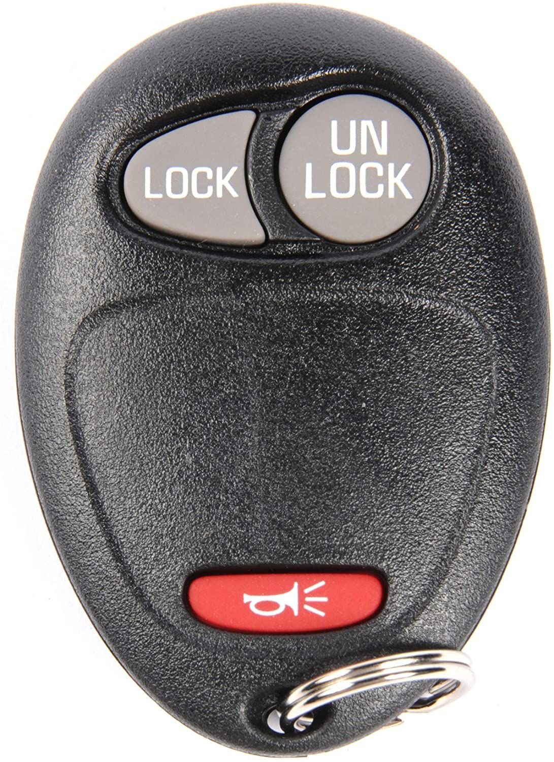

Is there a way to disable factory alarm on H3? Sometimes when I open the door the factory alarm goes off even tho there is an after market alarm system. So if anyone can tell me how to disable the factory alarm complexly would be amazing!

lol I don’t use that anymore I have an after marker security system but sometimes when I open the door the factory alarm goes off I went to 3 different shops they all found nothing wrong with the security system and couldn’t find a way to turn off the factory one so do u know how to disable the factory alarm?

Press UNLOCK on the oe rke=disabled. I rarely lock my doors, when I do with the rke, it activates the theft-deterrent system.

The only way to arm the factory alarm is to lock the H3 with the remote. The owner's manual explains it. If you unlock (disarm) using the OEM remote, then NEVER use the remote to lock it, the factory alarm will remain deactivated.
If you have indeed unlocked it (using the remote) and then never locked with the remote, and it's still happening, then your aftermarket alarm is not playing nice with the H3's electronics (not the first time issues with aftermarket alarms have been reported).

I don’t have that little black thing anymore and what happen is the car lock and unlock fine but sometimes when I unlock it and that sometimes the factory alarm will go off

and oh **** I don’t have that black piece to unlock it and keep it deactivated lol any other way to deactivate it ?
