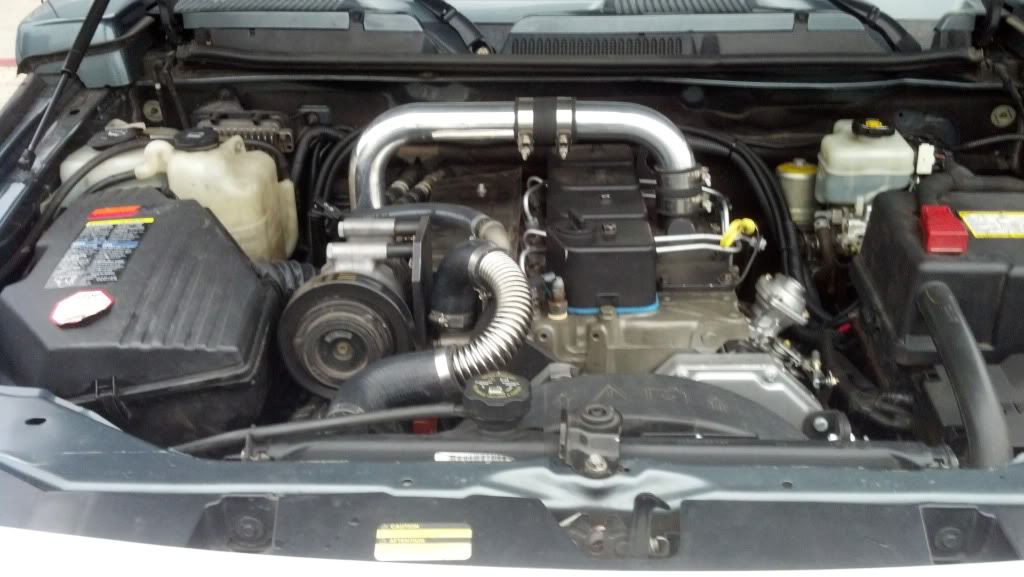

Its worth it. I just realized there may be a few of you here that haven't seen this linked on other boards.

Sounds like the user would have to have a considerable amount of know-how. Does the engine match the bellhousing, or does the trans go with it and it is shaft back?
Anything is possible, practical is a whole different story.

Need more info? Is there a link to on this image of an successful swap? Thanks

Ahhhh, the bump of a TWO YEAR OLD Thread to ask if there is a link with the picture posted by a guy that last stopped by here 2 years ago.

https://www.4btswaps.com/forum/showt...s/27760?page=1
Build thread here. Couple of hours worth of reading to digest.

Attachment 10876
I'm in the middle of the same swap. What did you do for fule pump and set up?

Just use the mechanical pump located on the block and run a suction line into the tank. You will want to remove the filter sock on the existing line in the fuel pump basket if you choose to re-purpose part of that assembly for the suction line.
