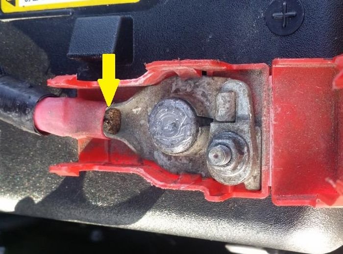

You can't properly clean the terminals the problem is at the wire crimp. Btw, the master switch needs reset.

That makes sense, Im stopping and getting new terminals, as far as master switch reset, what is this and how do you do that? I did a search and didnt find anything
Old Dec 11, 2020 | 10:40 AM
You don't need to reset anything. Get a quality set of Battery Terminal Connectors, like Stingers or your favorite brand. Do NOT use el cheapo auto parts replacements with a cover plate and two bolts. Replace the OEM terminals, they are JUNK!!!! No such thing as "not too bad."

Well Id like to thank everyone, I put the new terminals on this morning it not only fixed my door locks and windows, now my dash lights seem to working perfect. I did the sunroof drain fix because I noticed a little dampness on the floor and yes the plug was 100% clogged. Thank you guys, I was so close to taking it to the dealer. I just need to figure out why I have no door chimes but I'll post a new thread for that..you guys rock.
