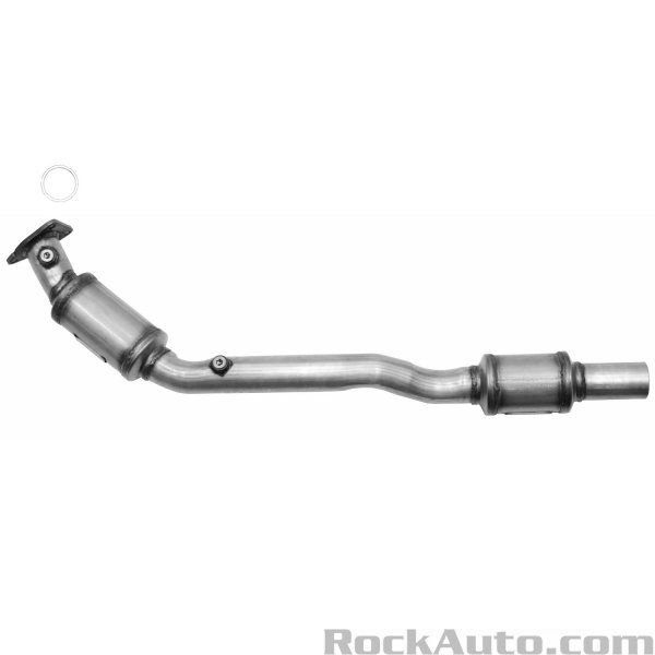

Don't confuse what you may have read about I5 H3s with yours, like removing pre-muffler. Take a look under there to see the "problem" with your going true dual idea. You should still keep a cross over for balance even if you find a place make a duel setup. With Alphas, you are going to get a sticker shock for the Cats, like almost a grand for the front pipes alone, and they are getting harder to find.
Finicky sensors? Never heard of that. My 09 Alpha Off Road has more miles than yours, zero issues on Stock front pipes (Pups Cats and secondary Cats) with MagnFlow Cat back, TSP Low Lift Cam, LS6 Springs, one of our Intakes, AFE Filter, SuperModulation PP TB and SFAN 4500 Efan, with my HPTuners tune. One of the keys to not messing up Cats is always running top tier type fuel.
Not looking forward to having any Cat issues, buy probably gonna happen someday. Then I will start that process.
Only the front Pup Cats are monitored, so you could loose the second Cats.
They are both in the front pipes, one just behind the exhaust manifold flange, the second further downstream after the second O2 Bung.
