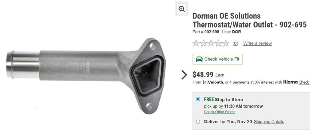

Originally Posted by Justinh
Interesting. Appreciate the follow-up.
The manual doesn't say anything about sealant or gasket for the housing. Is it just metal to metal?
There is a rubber gasket that fits into a groove on the bottom of the housing.
