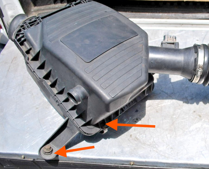

I've indicated the only locations that continue to collect coolant in the image below. Note: This is not my air intake box. This is just a picture I found that clearly showed the locations I needed to indicate.
Coolant collecting in the well where you bolt the box to the engine bay as well as right above the front retainer clip closest to the radiator.
There is minimal signs of coolant splatter around both of these locations on the air box but not significant enough to point to a source. The only thing that makes sense to me is a crack in the long hose that winds its way from the bottom of the coolant overflow reservoir and connects to the top of the radiator. So far, I have only inspected the hose while attached and I cannot pinpoint any holes or leaks. I've looked numerous times with the car running and at temperature, with the engine off, and when it's completely cool with no luck. I can get a picture of the current coolant situation if needed, but that front bolt well is basically filled up with standing coolant so we're talking about more than just a few drops.
