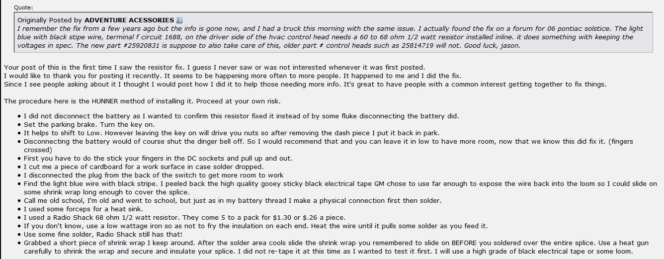

You need the 'resistor' fix. See below.
File Type: docx
File Type: docx
