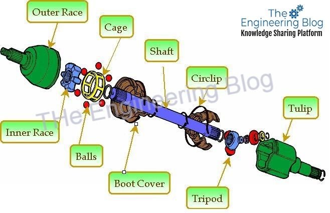

Measured when/how. The H3/H3T Half Shafts have two Boot covered CV joints that both allow swivel and on one end allows linear extension. To compare apples to ..... you have to compare both fully extended.
Something I posted back in August 2017... obviously prices went up, but makes no difference as the point is still the same.
"I would never use any other half shaft than the ACDelco GM # 15886012 redesigned version from late 2008 that were installed on all 2009 and later H3s, and the end of the 2008 run of H3s. You can buy them shipped to your door for $273.45. They are beefier and a wee bit longer (GM learned something from the launch of the Alpha in 2008 and its steel front diff vs aluminum).
IMHO, when you pay $70 for a $275 part, you 100% get what you paid for, not much. Then again if you like stuff from China and Taiwan installed on your truck, have at it, as Cardone may rebuild stuff, but with what on the inside.
Good luck.
The top one is a 2007, the bottom is a 2009.
The off brands are cheap for a reason, some are just re-manufactured early versions that you don't want, some of the foreign crap are like 1/16" too short as well. You do not want your half shaft popping out of the axle carrier when buzzing down the highway after a bump. Yes, this has happened, people posted it here years ago."
IMHO half shafts are not where to skimp. There are some of us here who have been at the H3 game using them for work and wheeling a long time, been there done that, saw people try that, and have a pretty good idea what works and what is just a band aid waiting for a repeat. There have been people that went through 3 cheap shafts in less than 6 months....... I have better things to do that practice axle replacement work.

24.9375(24-15/16") COMPRESSED! The the inner joint tripod/tulip allows the shaft to retract/extend as far as needed without separating. CARDONE 661417 Specifications
