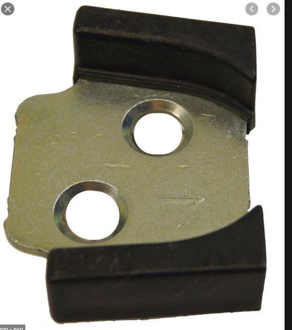

I rolled some electrical tape around the black plastic and this helped eliminate the clunking and door shuts tight.
Old Jun 18, 2020 | 09:56 AM
Do you still have the black plastic covers/spacers on #4?
Remove the entire #4 assembly, remove the plastic, put #4 back on the H3, use a 5lb sledge to slightly spread the "wings" out. Remove #4, put the plastic back on, put the entire assembled thing back on.
Also remove loosen the Torx bolts on #2 and see if you can move it toward the interior. You may get a little movement!
