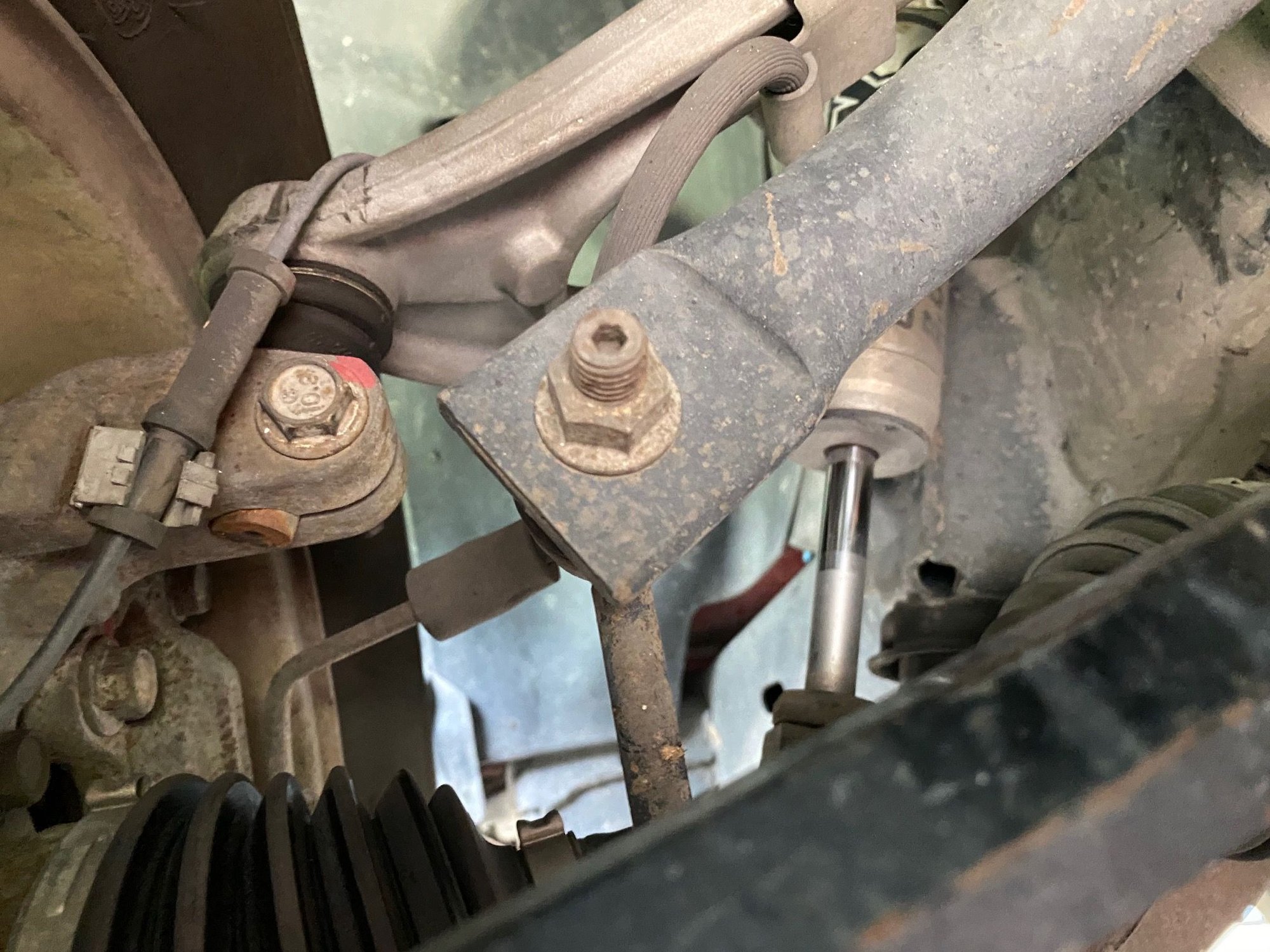

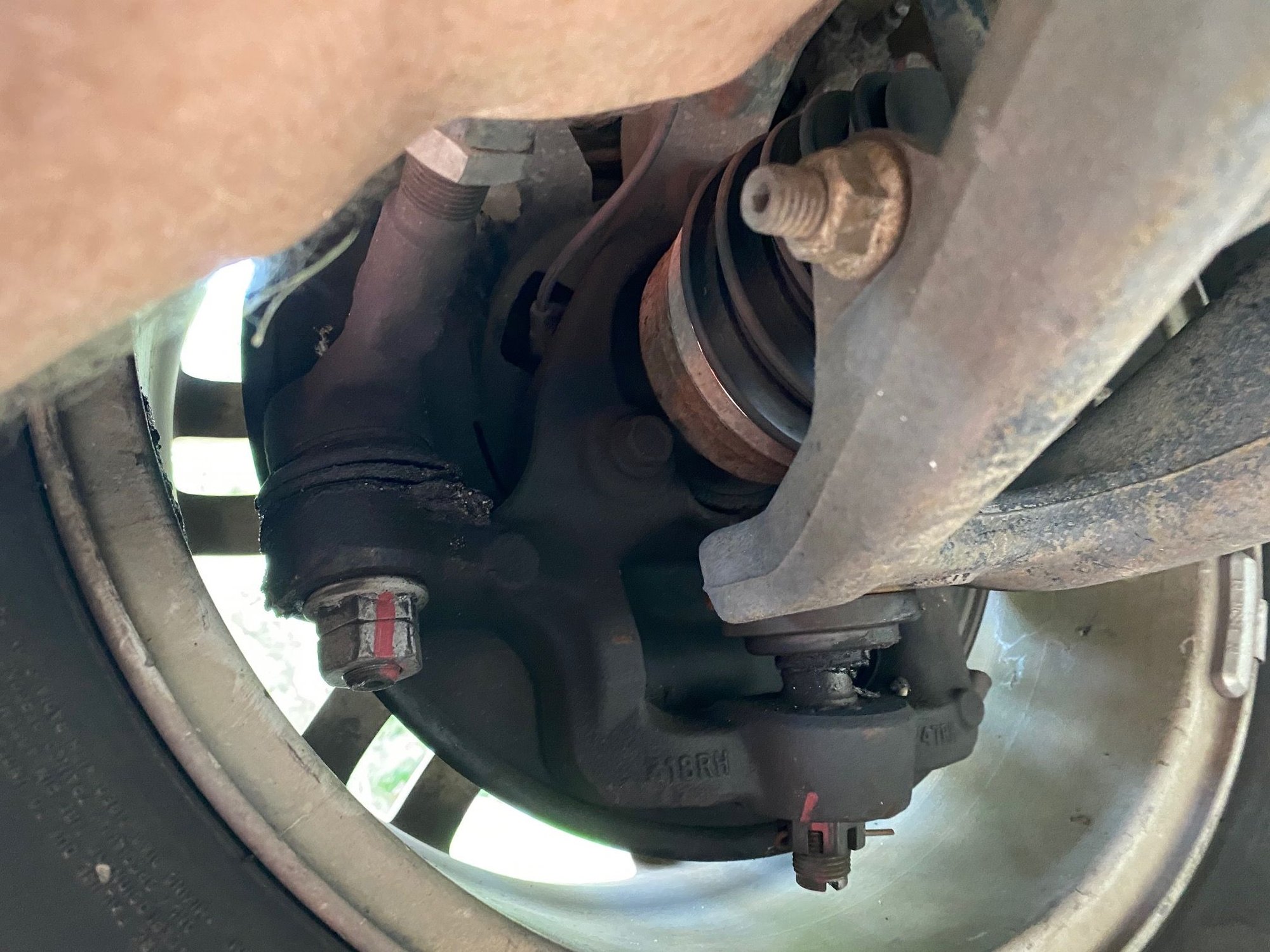

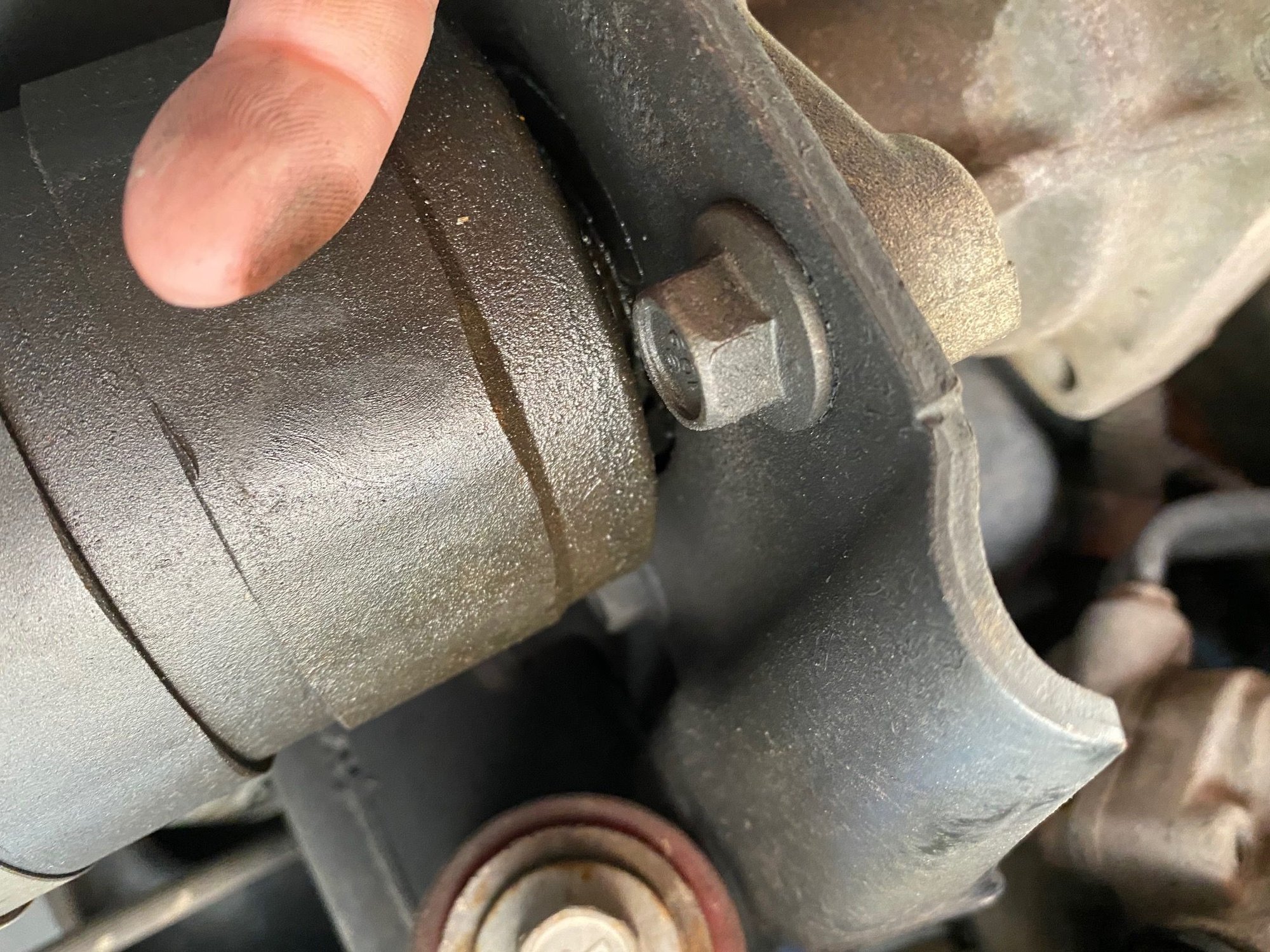

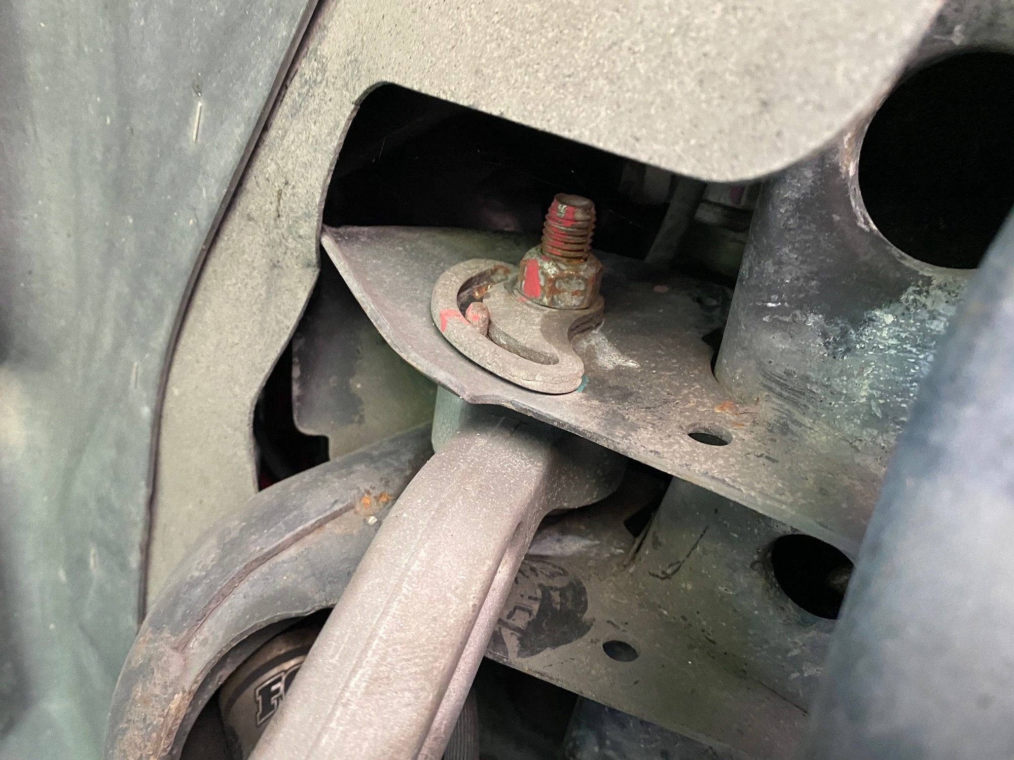

I am absolutly pissed what I just found after finally crawling under the truck from a squeek that started two weeks ago and now since the steering wheel grabbed to the right when i was turning and didnt want to go back to center; squeek started really soft now its very noticable. Ive had my truck in one shop for the front end upgrades (there was some attemted ****ery then with the tech saying i drove the truck in with a broken ABS sensor wire). Im not going to name the shop yet, but it is nation wide.
Please tell me what you all see wrong in these photos and how you think it happened. -I am schedueld for them to do rear end upgrades this coming Friday, I told the sales rep yesterday that I want them to look at the front for a squeek. And now I am preparing for a battle.
Questions I have:

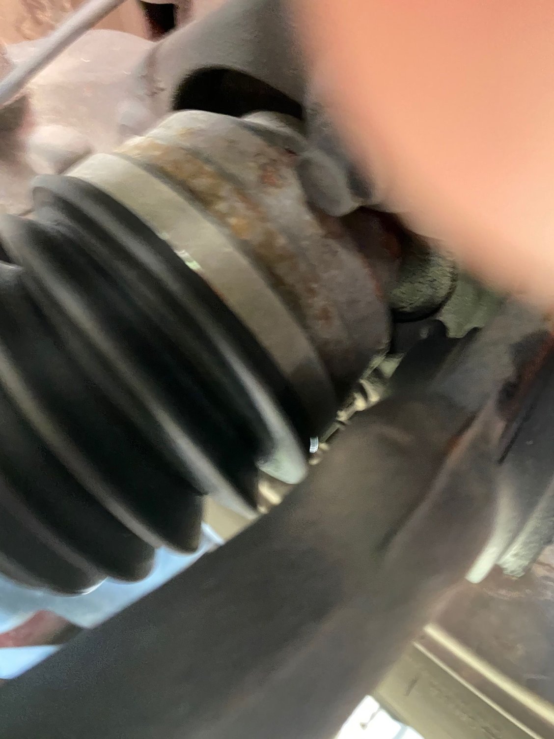

  1. Looking at the front diff; should I be concerned about the oil leak out / is my diff damaged possibly? Does this indicate the seals are bad?

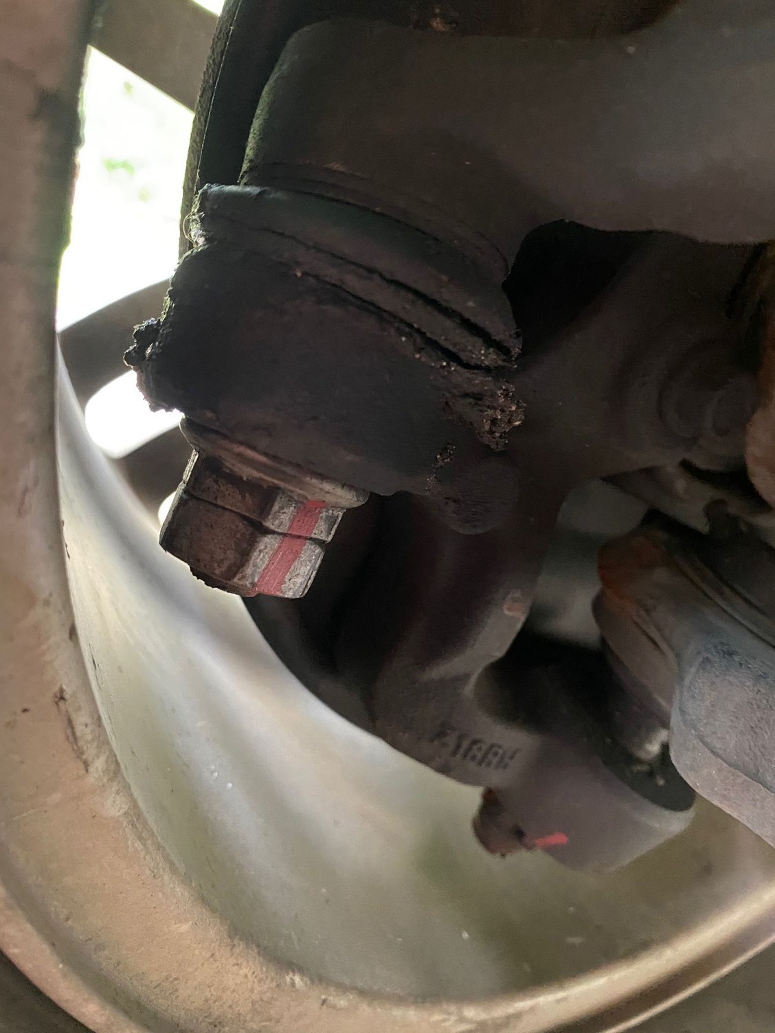

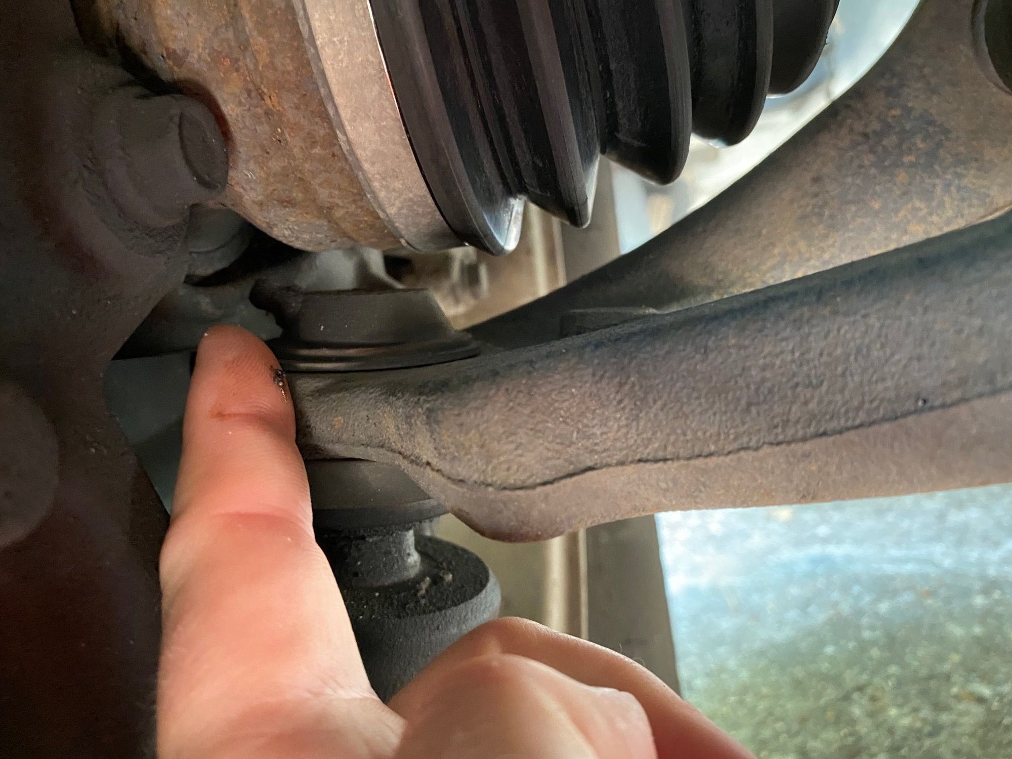

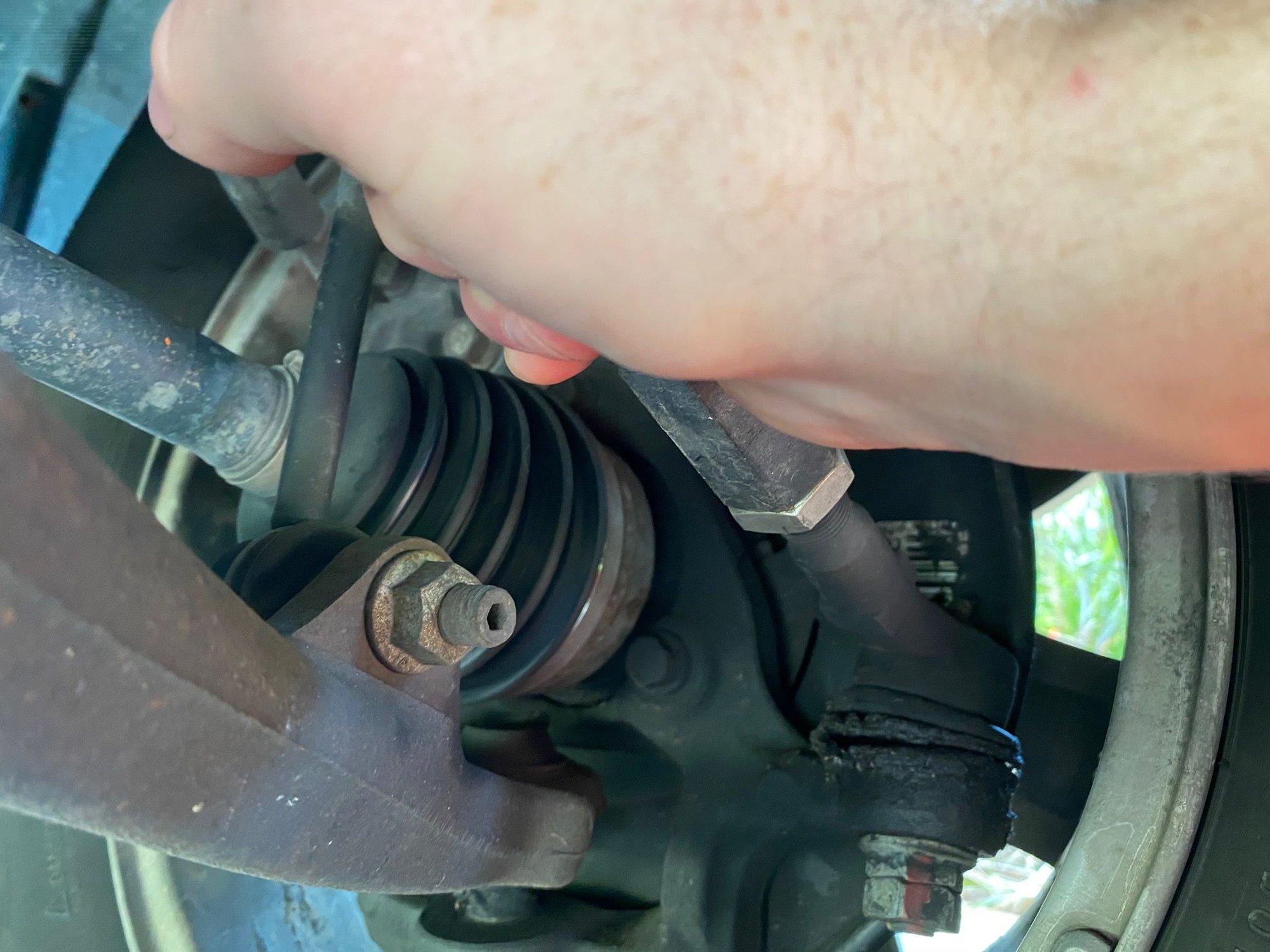

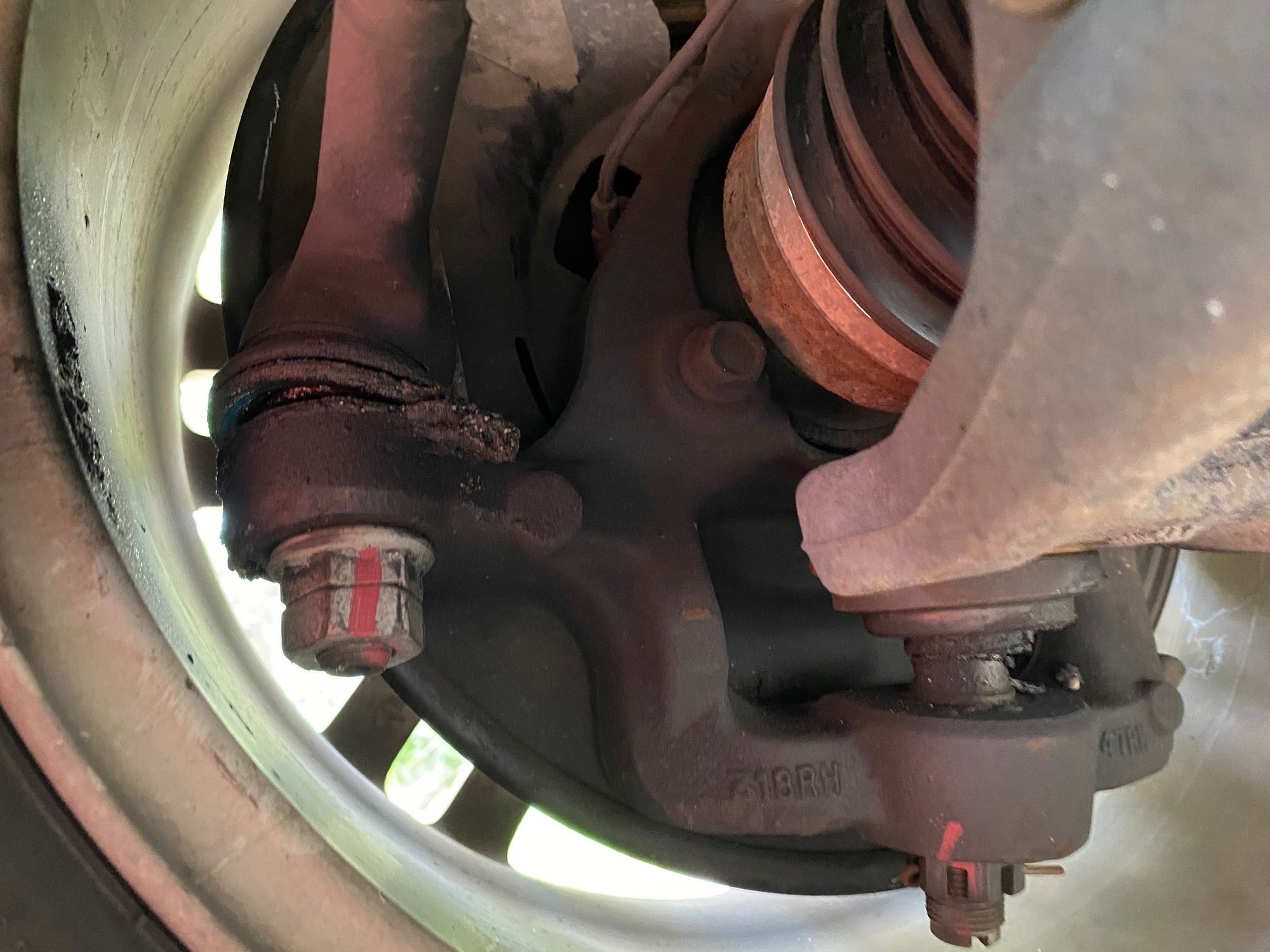

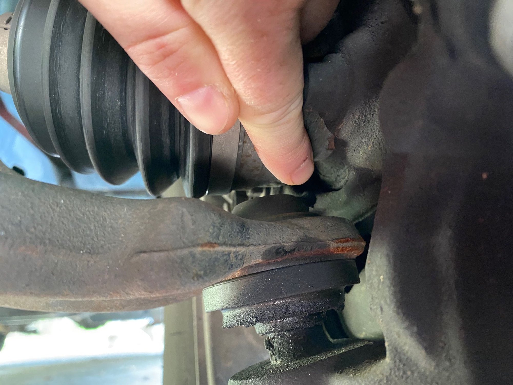

  2. The ball joints' zerks point at the wheel (WTF), isnt there suppose to be a boot installed on these? are these still good?
  3. Tie rod out ends still good?

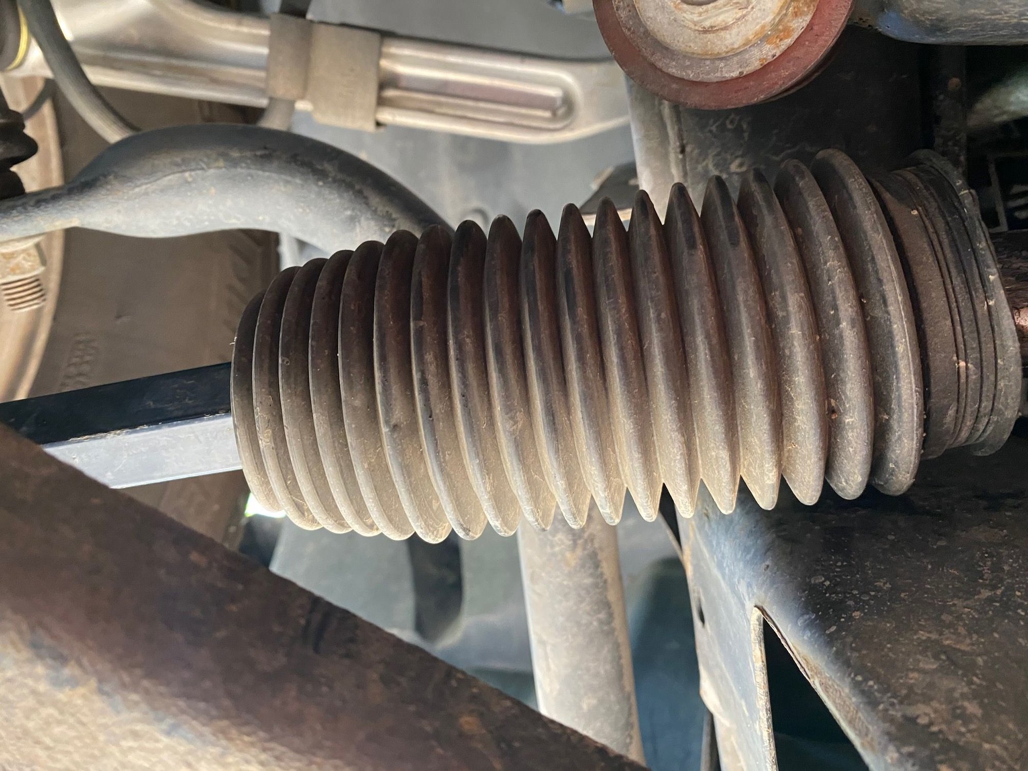

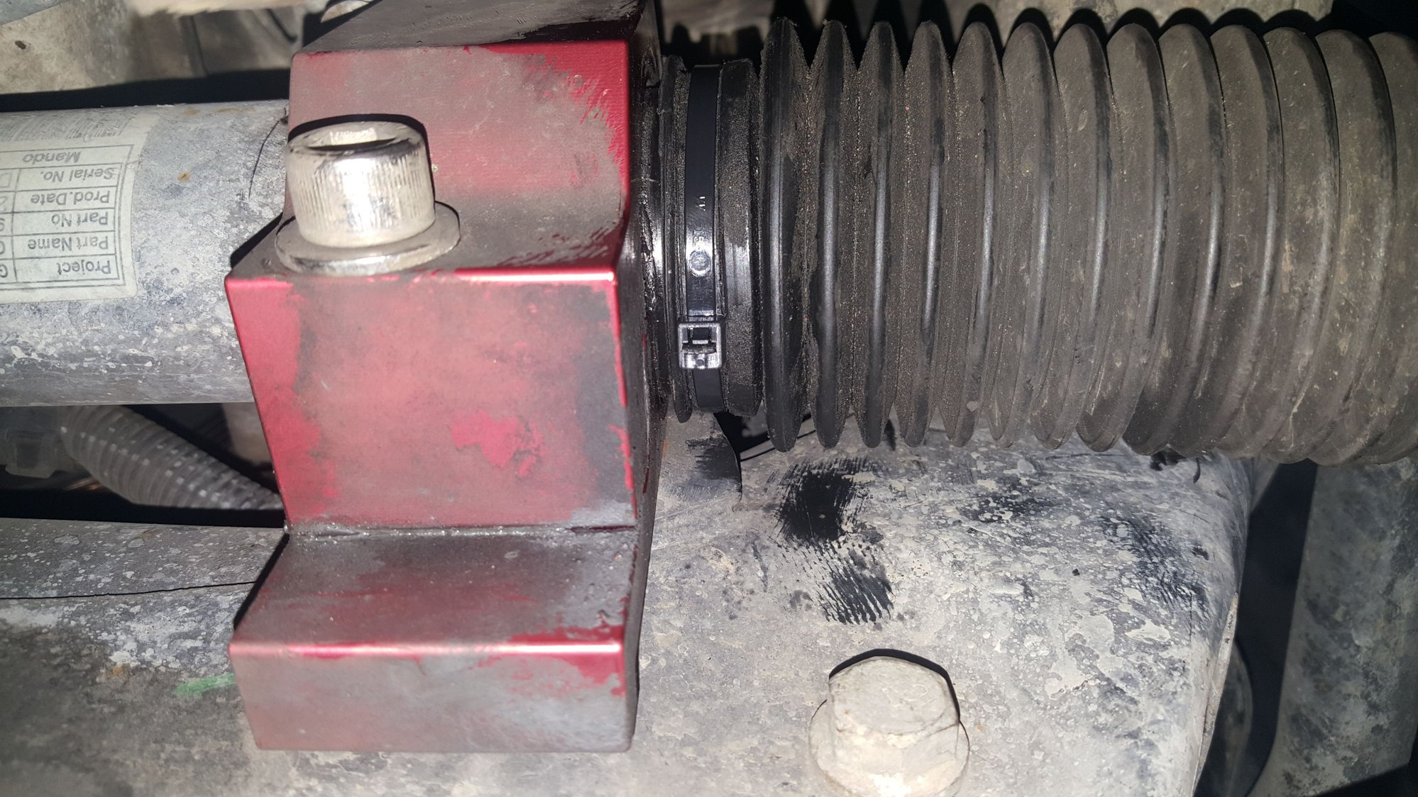

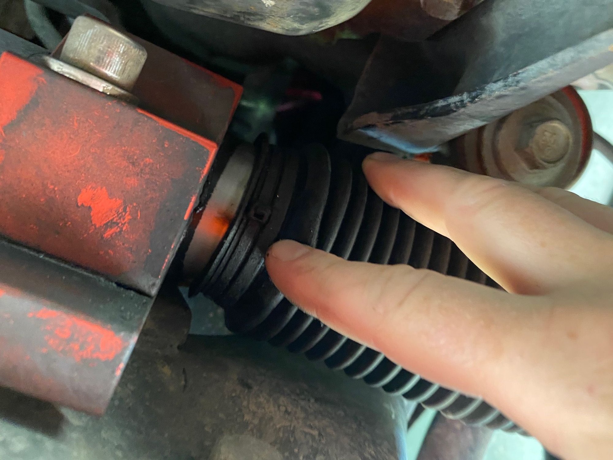

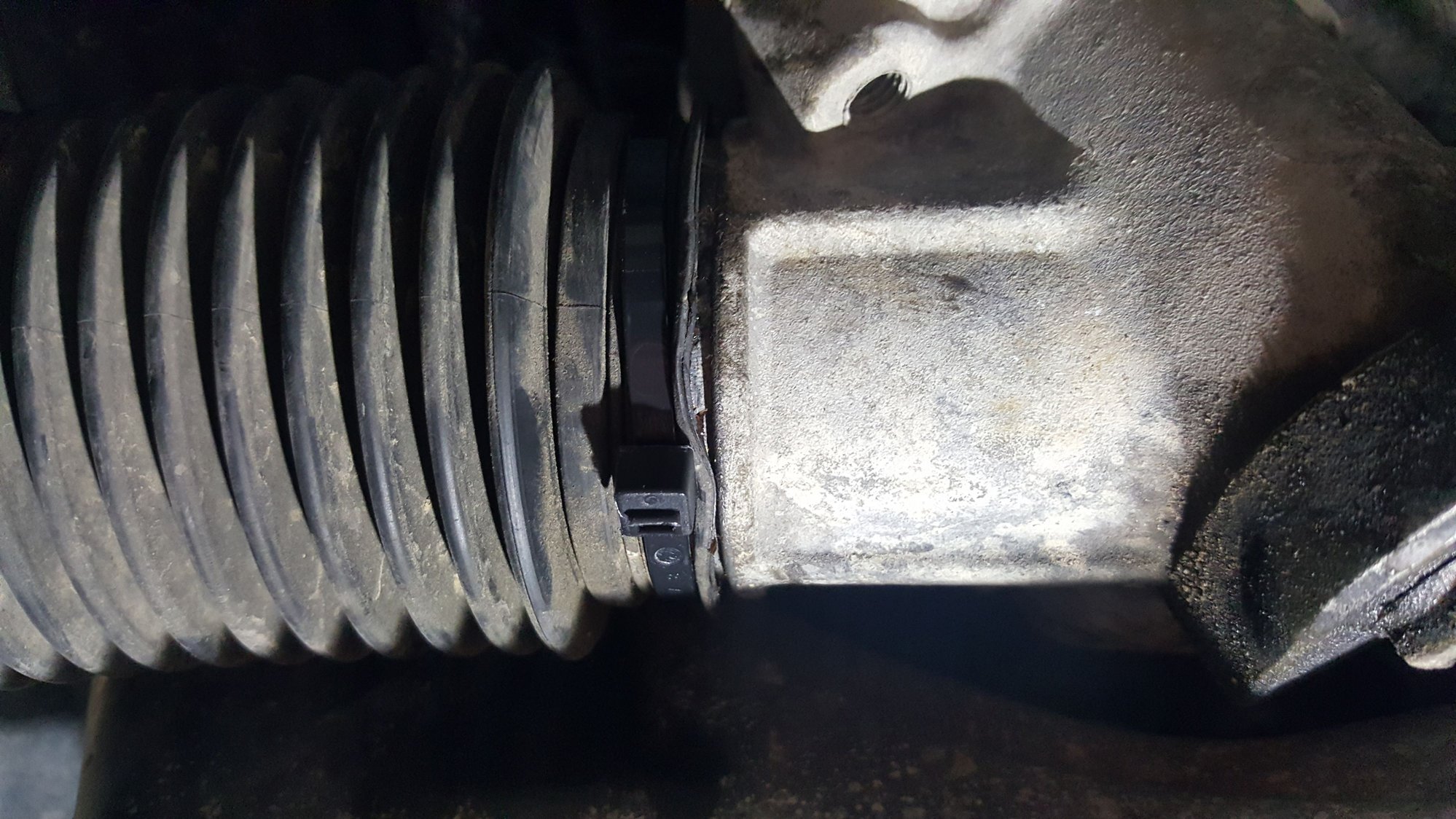

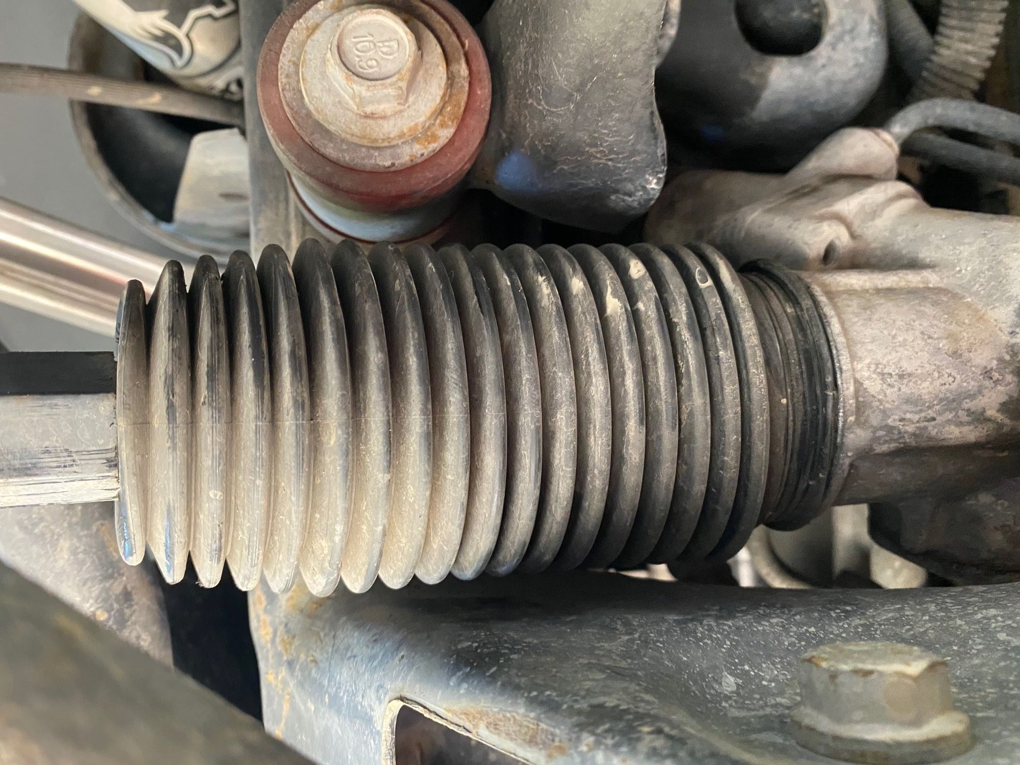

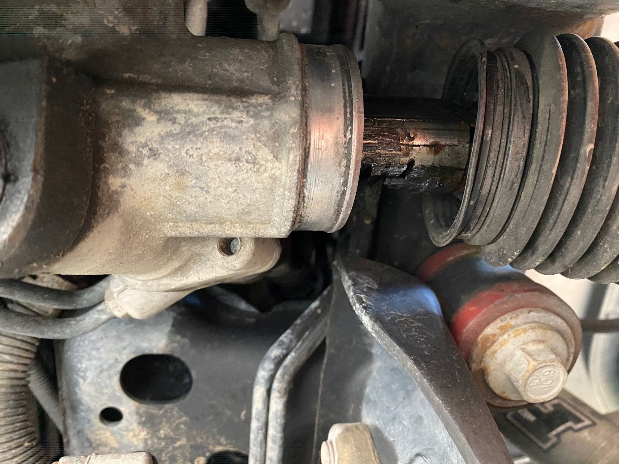

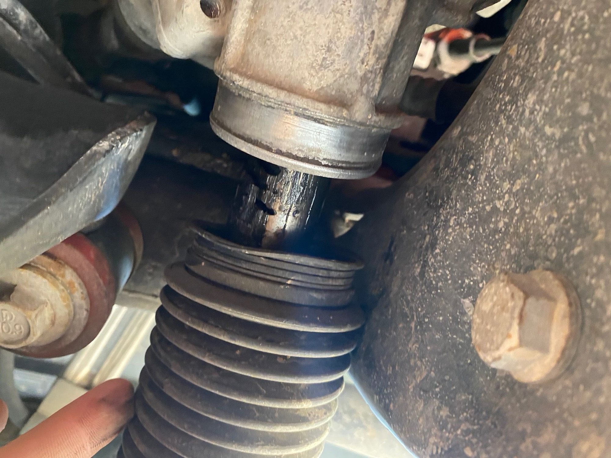

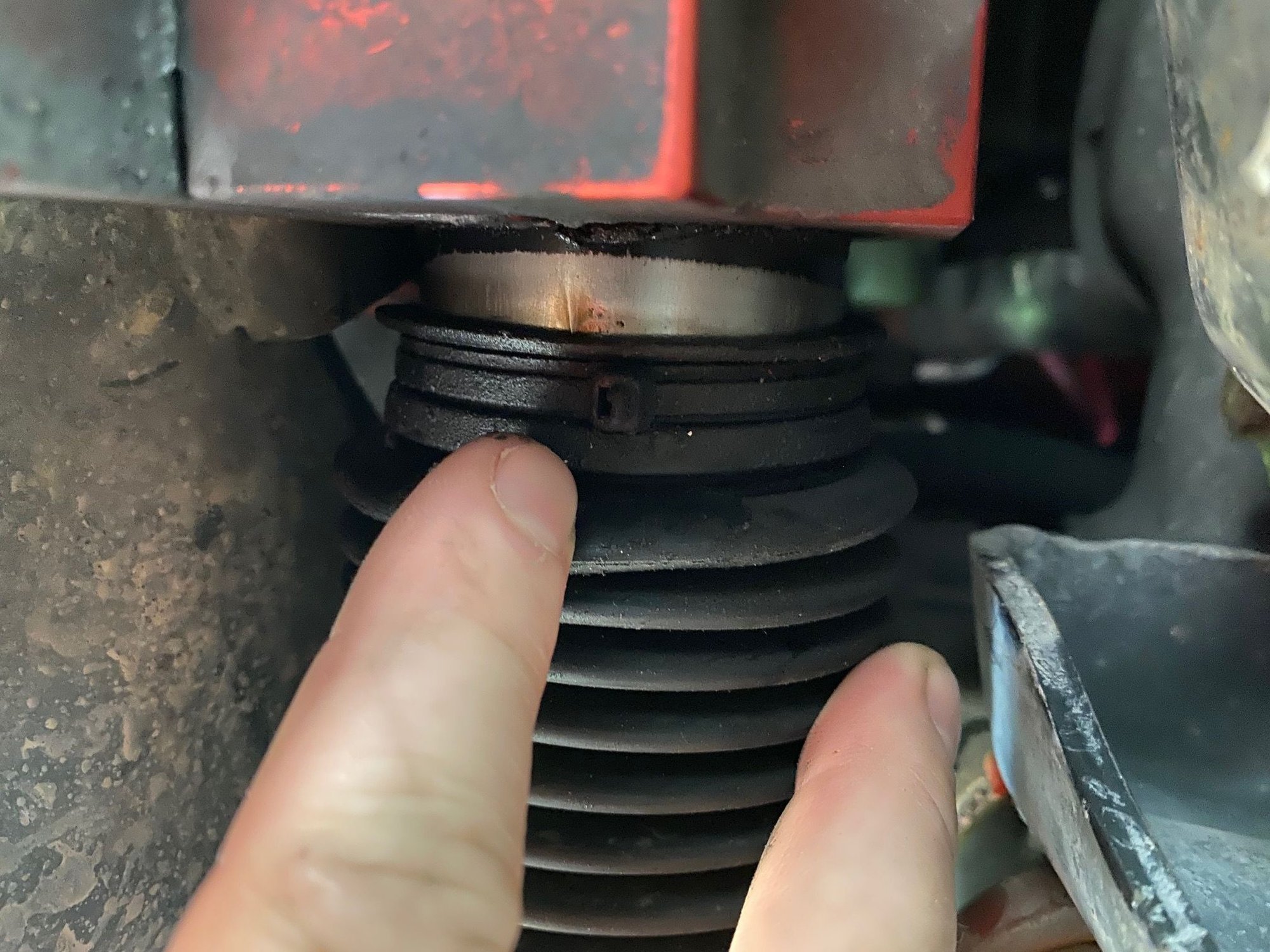

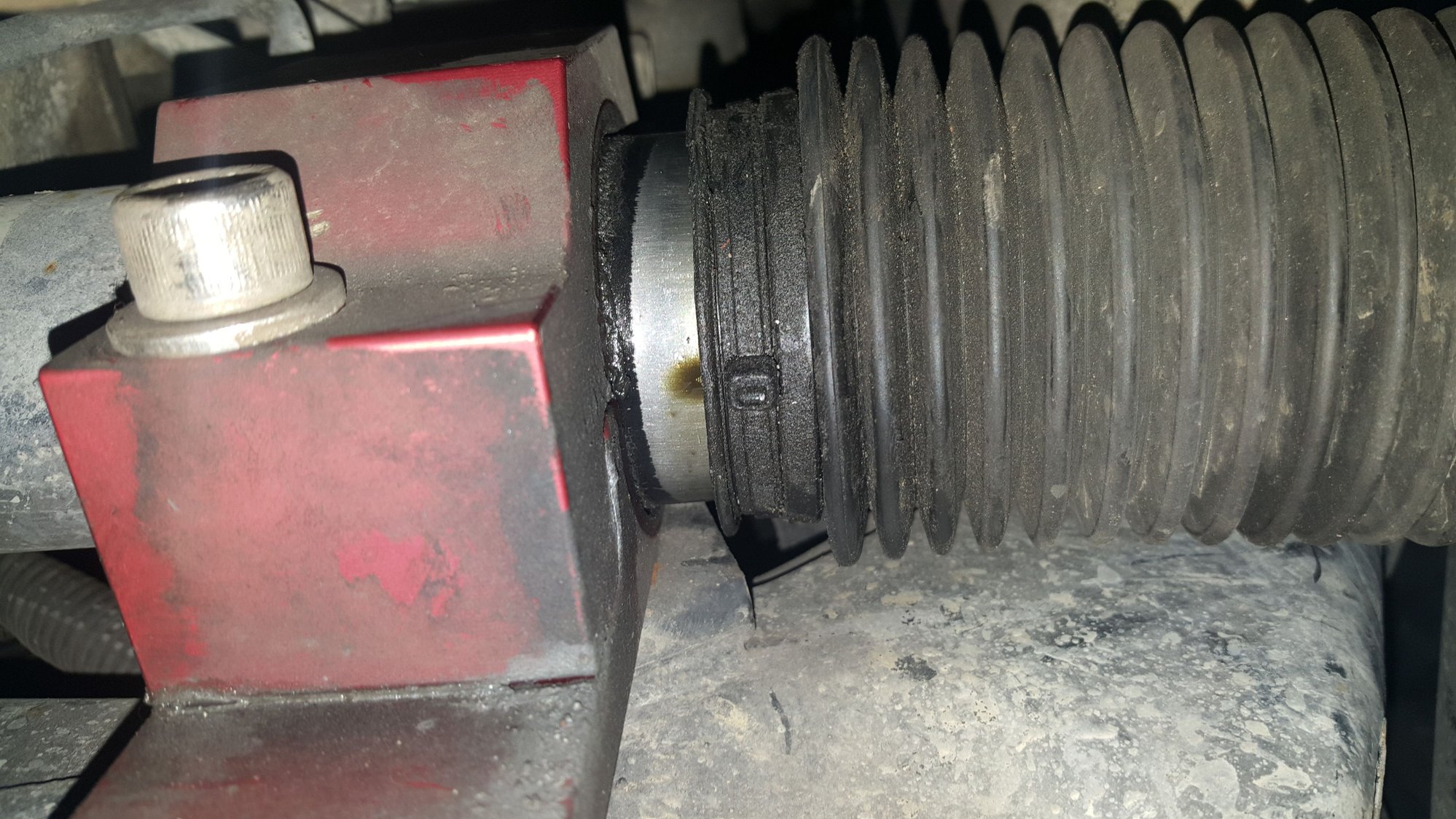

  4. Steering rack, its shot isnt it / is that a crack on the rack? Would a zip tie on a boot cover just magically fall off?

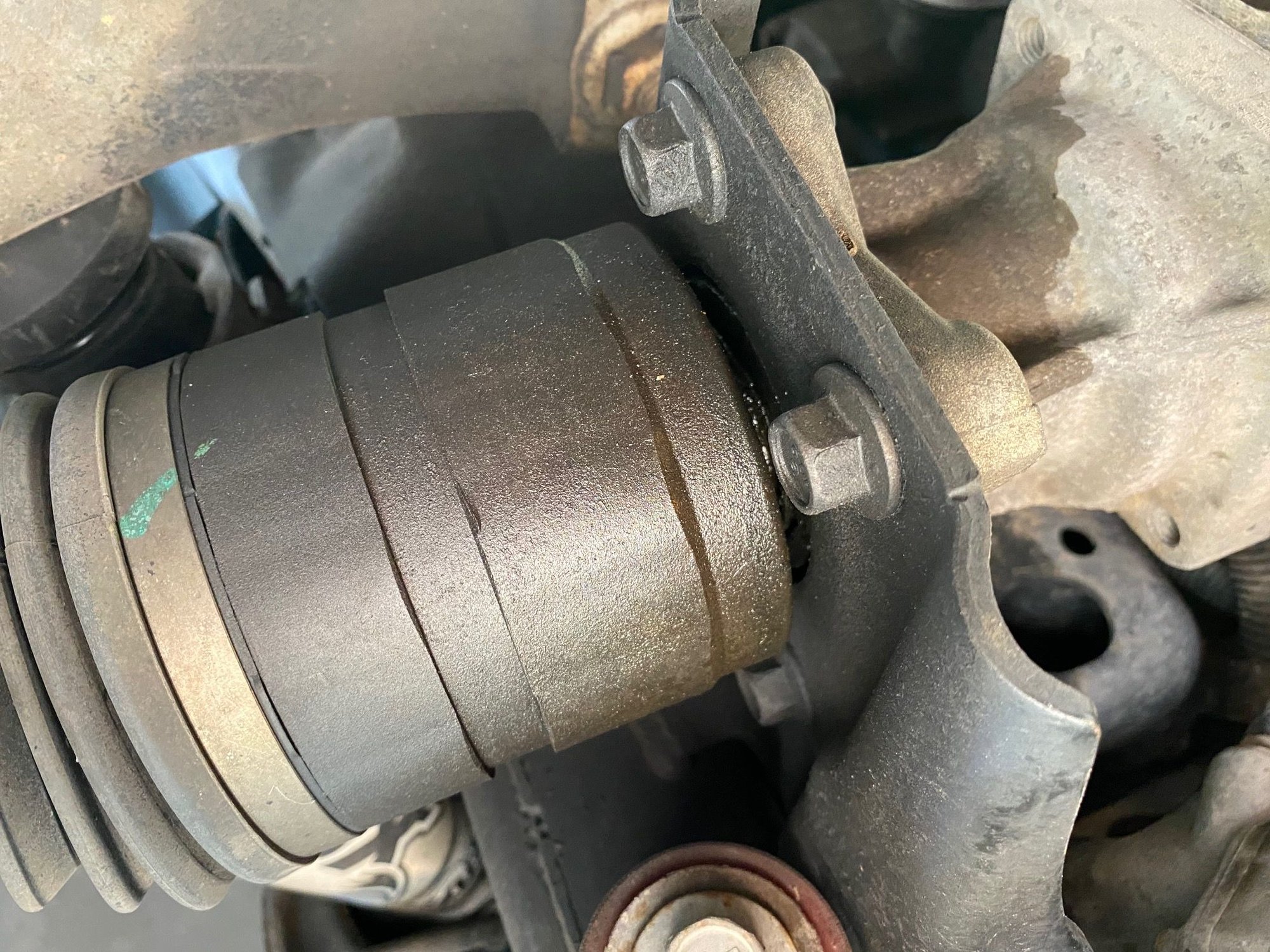

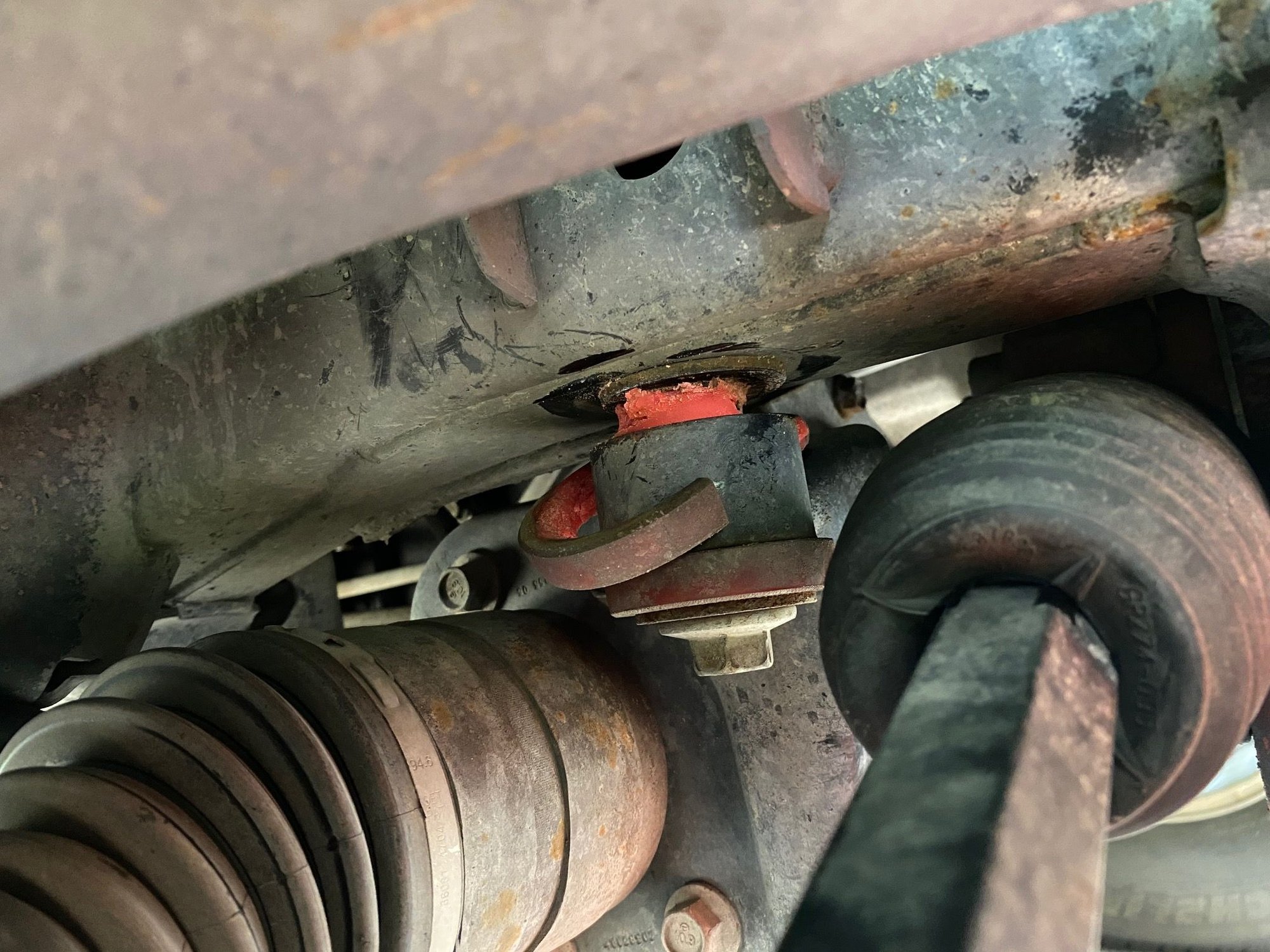

  5. Front Diff Bushing....how the **** does the bushing just explode? These poly bushings are harder than the OEM rubber ones...
List of Front End upgrades installed-
May 2015: Outfitter Design Tie Rods
June 2015: Scorpion Steering Bracket & Differential Bracket Bushing
February 2020: Moog Upper Control Arms, Moog Ball Joints, Leveled and Aligned. Took three days b/c their tech cut the driver ABS sensor, then claimed I drove it in like that
Im cringing now after waching this after seeing how my ball joints are installed.
I need all the help our HUMMER comunity can give me on how to approach the shop on this one.

New rack (you can sell the new 16mm tie rods it comes with to someone), new tie rod ends (Extra HD), new differential bushings, new sealed lower ball joints and new diff seals. Make sure to use an axle seal protector (Kent Moore J-44394 Axle Seal Protector) when installing the half shaft back in. The half shafts have very sharp splines and will slice the brand new seals.

Dwaine of Prefered Chassis Fab said the diff crossmember bushing could be damaged from "jacking the front of the vehicle with the jack/floor jack under the front differential carrier can and will cause the end supports to fail. The end supports are not designed to support the whole front vehicles weight, they are designed to support the "hanging" of the front differential/axle assy."
So how ikely would it be that the 4x4 shop in February did that while leveling the front and replacing an ASB sensor, lower ball joints and Upper control arms?

Anything is possible regarding the 4x4 shop. Some places hire knuckleheads and let them operate nearly unsupervised so "work" can be done quickly. You want the shop that takes pride in their quality of work, not how quick they can get your truck out the door for payment. When you just slap in the lower Ball Joints without paying attention to the direction that the grease zerk is facing, I would say that is evidence of hurry up rather than planning.
I would not jack anything except the frame and rear axle.

Just spoke with the shop manager. He appologized for his Tech installing the lower ball joints backwards (in the way they couldnt be serviced) and provided some photos showing the steering rack is actually not cracked. He kinda took responsibility for the steering rack boots not installed with metal clamps, but his shop didnt install the Outfitter tie rods. He said the tie rods are fine and the grease squeeze out is normal. He further said the tie rods should be easily rotated in the hand (is this true?).
He thinks the diff bushing had been cracked in the back for a while and there was dry rot (It was installed in 2015 & not by his shop). He said b/c they did the the front end leveling, by 2", this changed how the load goes to the differential which most likely caused the bushing to completly fail.
I dunno, I dont think this should have happened but its not as bad as I first thought. He assured me its safe to drive until i get new bushings.
A few questions I have are: whats causing the squeek, is this from the diff bushing? (I know the clunking on acceloration is from the bushing.)
Im gonna have them install the Outfitter bushing kit when I get it.
