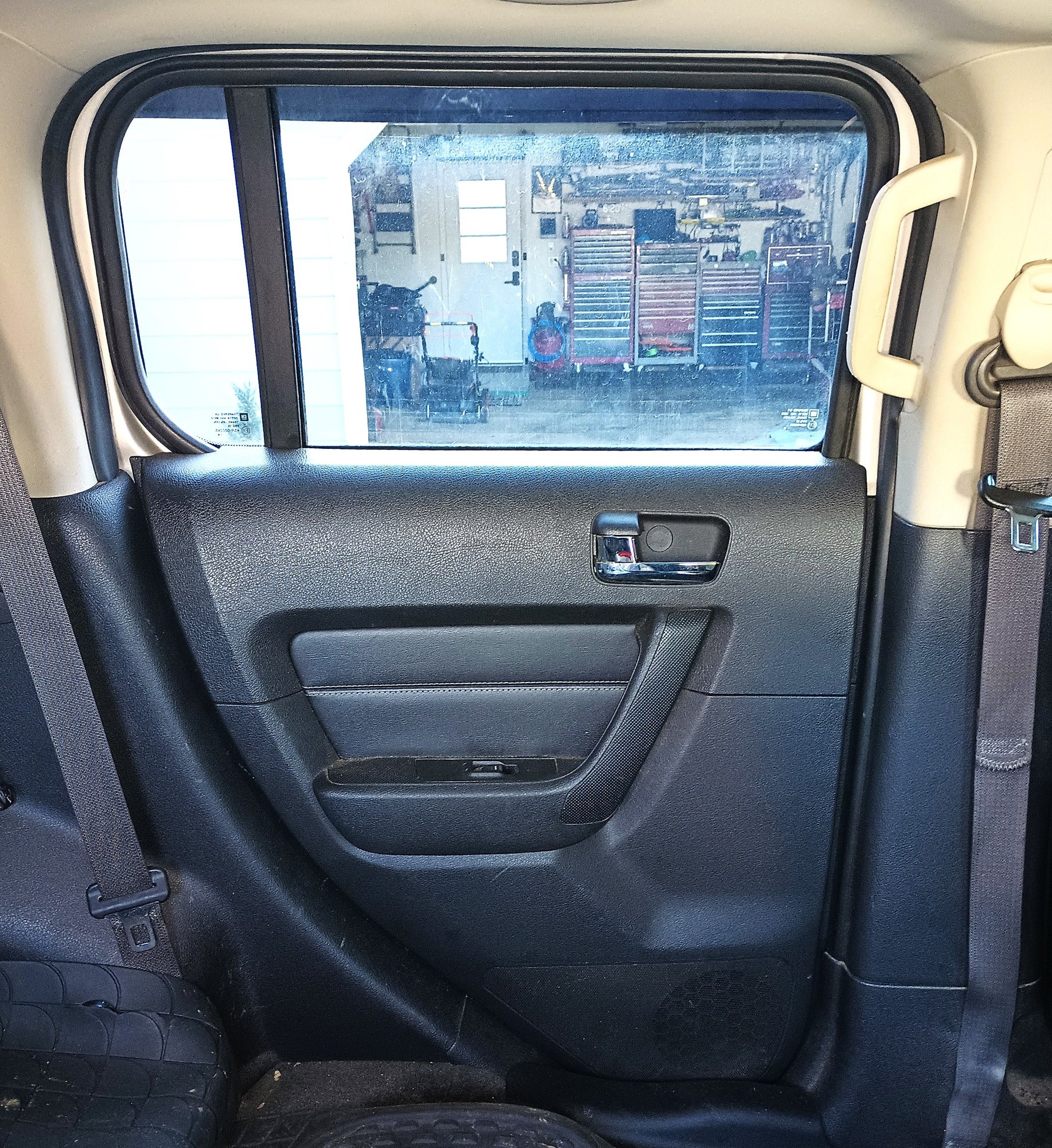

Hummerz, if you are saying the panel should be removable with the door closed, well, it would be near impossible because the panel rim is covered. What is "there is a cover to access the cables behind the interior door handle"? I don't see a way to access the cables.
Maybe if you sent over a couple of those tool boxes shown in your pic ...
