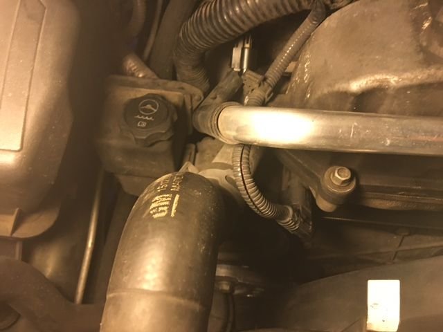

does the 3.7 have one or two cps ? i can find one on front of engine passenger side.
the searching i've done shows two but on 3.5 L motors.
i'm not talking about theVVT SOLENOID/ACTUATOR but the cam sensors.
thank you very much

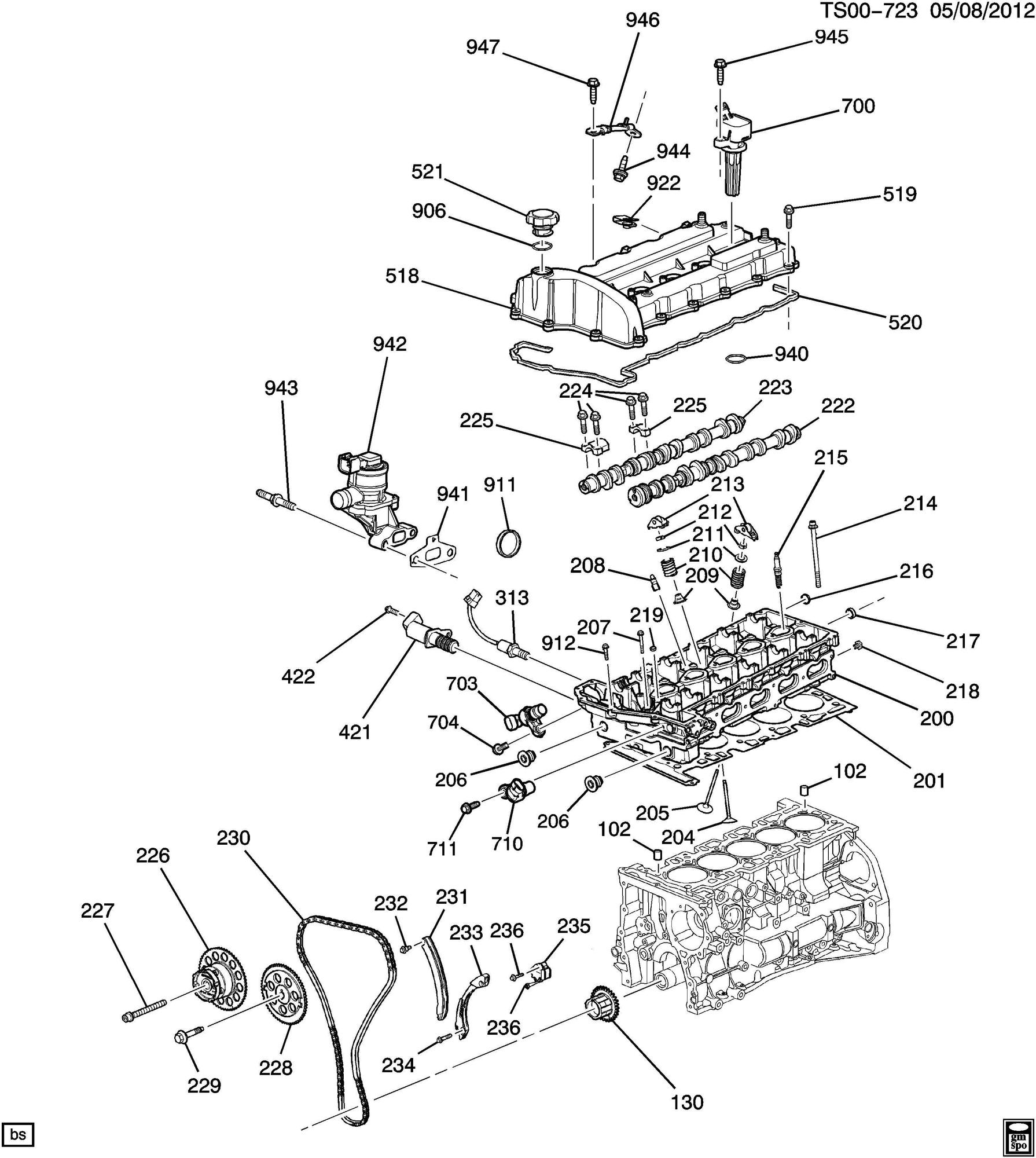

All the I5s have TWO camshafts. How could one sense both? 3.7L CPS #s 703 & 710

my 2010 does not have a cam position located at #710

Default no cam sensor on in take side
no cam sensor intake side only exhaust side of motor

My '07 LLR has 2 cmp's (intake & exhaust). Not long after my H3 was assembled, GM filed for Chapter 11 reorganization, therefore could not afford 2 camshaft position sensors on the LLR 2008-2010. You only get the exhaust sensor. Live with it!
