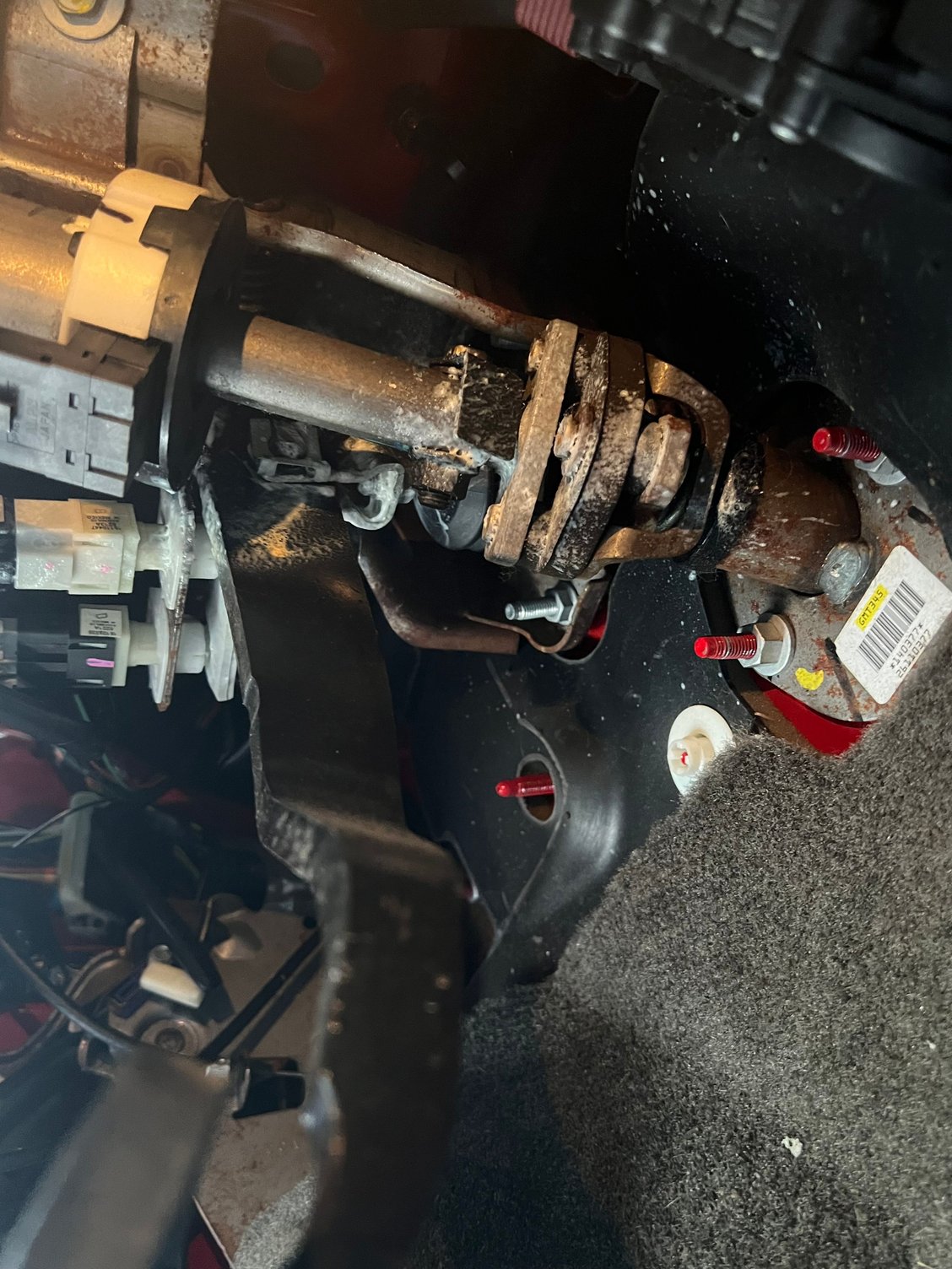

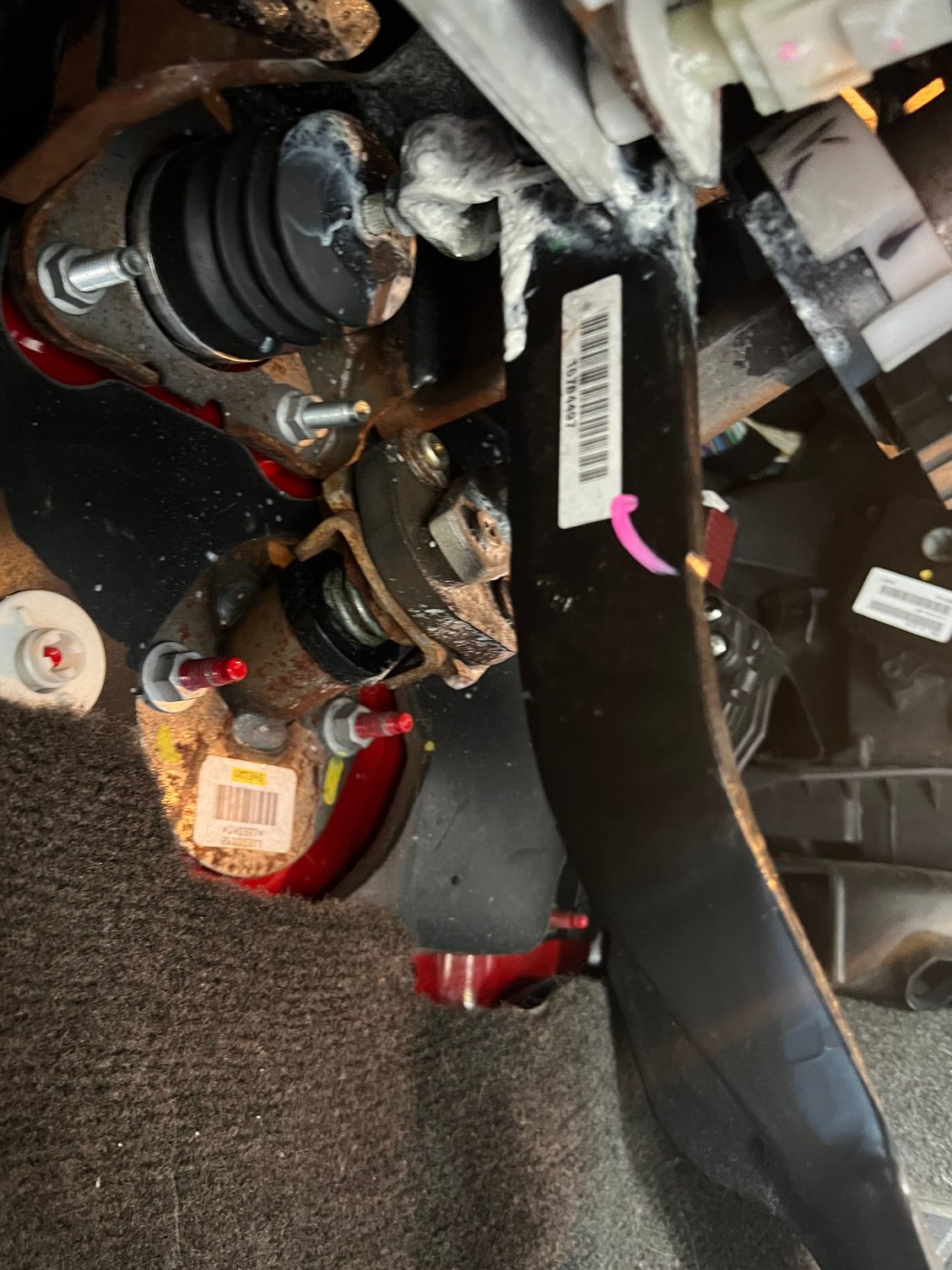

At about 105k miles on my 2006 H3. The pads, rotors and calipers are all in good shape. Lately whenever I press the brake pedal it creaks. The actually pedal. I got up under there and sprayed it with some white lithium grease which did decrease the noise but it’s still there.
Im just not sure which part it is causing it? With the car off I can get under the steering wheel and press the pedal with my hand and hear the creak clearly but it sounds like the entire pedal.
