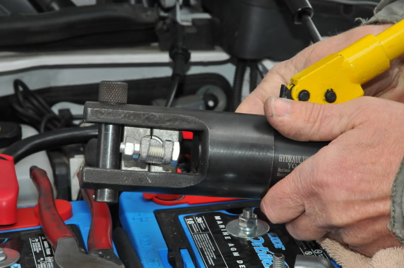

I put on some of those temporary "emergency" clamps just to layout how I wanted my cables to run and get me to the shop where there was a hydraulic crimper. These will carry the full gauge of the required size cable for full amperage. They come tapered to fit tapered posts and in a different size for positive and negative.
After swedging them I slid the shrink wrap over the ends and heated it to help keep moisture from wicking up the cables. With sealed batteries there is very little if any corrosion.

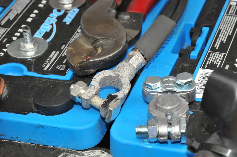

I replaced those OEM main terminals. I decided to just torque one past the point I consider safe to see if it would ever tighten enough that I could not move it. It begain to buckle underneath and actually loosened it. Snip!
I have now Hunnerized the new main lead terminals. Universal ones don't fit the negative tapered post. Those first ones I used in the proto-type are those "emergency" style you find everywhere. You will have an emergency if you depend on that crap. They do not even provide a tapered nut anymore, so it does dig into the lead before it gets tight! I drove the 60 miles to my Brother-in-laws electrical automotive shop. You think I'm pickey!!! He has a great selection of special fittings and several high tech crimpers. We used the hydraulic ones and they are CRIMPED without deforming.

We had to make some custom dies for the hydraulic crimper to keep from distorting the fittings. We did it in two stages with two dies. The one that came with it are for larger wire and terminals. Like for John Deere's. That of course required us to machine our own dies on a verticle milling machine. Another excuse to play with neat machines. He was busy so I got to use his special tools. I used lead coated copper fittings with closed ends and sealed them with shrink wrap lined with adhesive that when shrunk really seals things up. So I did not pursue the marine grade tinned wire.
This is my protype shot using shop supplies I had, to mock up the cables before going down there.

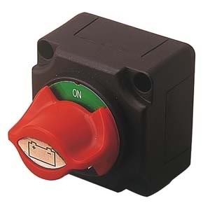

Found a possible switch if anyone goes that way. It's inclosed so will be protected. I found another place that indicates those panels like you see in the top can be removed on any side to allow the wires to go in.
Battery Switch with **** from Wholesale Marine
Here is another for a little more money but not as boxy.
BEP 701 Master Battery Switch at West Marine 710 1641&Ne=0&Ntt=Batteries &Ntx=mode matchallpartial&page=CategoryDisplayLevel1&isLToke nURL=true&storeNum=5002&subdeptNum=9&classNum=297
