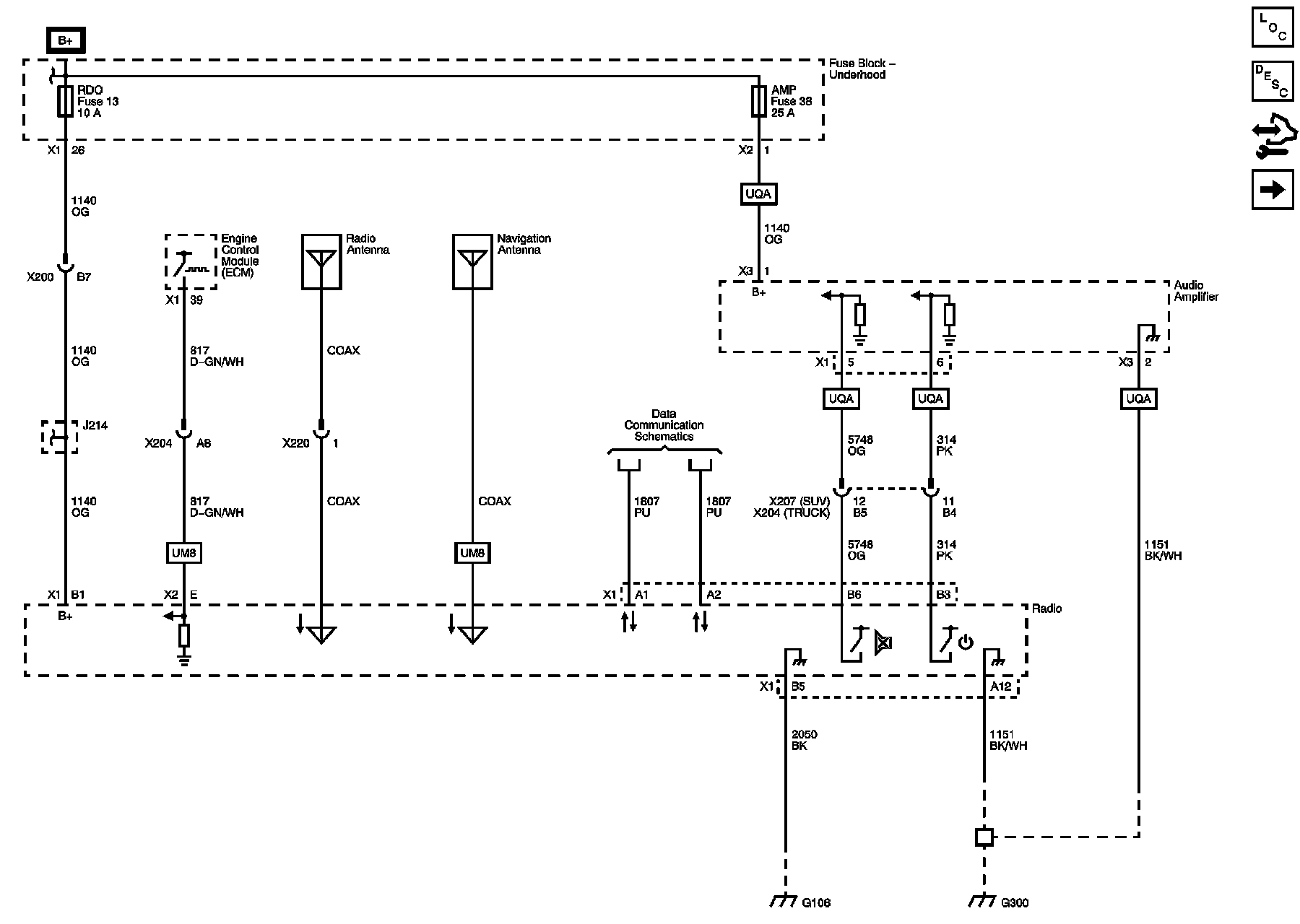

Are you all running a 12v red wire from the battery to power an aftermarket unit or should the adapter be plug and play? I can't seem to get power to my radio

check for a blown radio fuse at the fuse box for whatever vehicle you are driving since you did not say what you have.

look here at the wiring. look at fuse 13. check yours.

then you probably have the wrong adapter. the diagram above shows you what wires are what.
